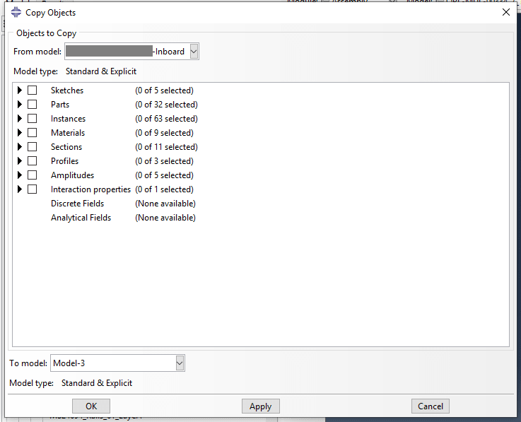

You can use Model —> Copy Objects tool available from the Assembly module. It will allow you to copy selected objects, including instances and constraints.
Hi FEA Way,
That is the current method I am taking within Abaqus/CAE 2017. However, I do not have any options to copy across constraints such as couplings, ties, etc. see attached
Is this an update in more recent versions?

Yes, the option to copy constraints between models was introduced in Abaqus 2019.
That's a bugger. We aren't moving to the latest until after this project so that option is out.
As I will be using 2017 for the remainder of this project, any advice on getting these constraints to copy across?

Generally it would be easiest to copy the whole models in CAE and edit them afterwards. But since you say that you have performance issues when using this method, I think that editing input files and copying keywords will be the fastest way. You can also try to speed up some repetitive model set up tasks using Python scripting.
I'm already using a script to populate my fasteners and their respective couplings to bolt edges and faces. After looking into it further I think best option will probably be the *INCLUDE keyword. This way I can use the work I've already done, as long as my Set/Surface names are the consistent between models.
