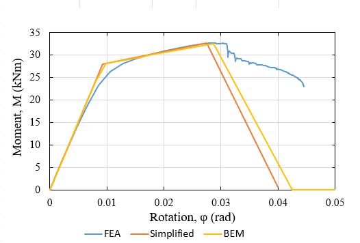

Hi all,
I am looking to use a connector element to model the semi-rigidity of a joint in a BEAM element model (BEM). The semi-rigid moment-rotation response was obtained using a SHELL element model and then idealised into the orange curve below (which I will input into the connector element to mimic the semi-rigidity of the joint in the BEM). However, when I analyse the results from the history output of the node the connector was connecting to, the yellow curve is what I am getting in return. Surprisingly, the response I am getting in return is 20% softer than what I inputted. Is there anything I am missing or doing wrong?
Thanks a mil!
Regards,
Heng
It's hard to say without any details about the model like connector type and behavior, boundary conditions and so on. If you double-checked the inputs, it might be best to simplify the model as much as possible (even down to the connector itself with minimum necessary behavior) for debugging.
Hi FEA way,
It is always you, thanks very much!
I think I found the issue, I was selecting the node of a BEAM element where one end of the connector is connecting to output the section moment and rotation which is the wrong way of outputting the results.
I then replaced the node set with the wire set defining the connector and selecting the moment and rotation under the connector history output variable list. This gave me matching results. I think the rotation/moment I was using earlier from the section involved a 75% average from the adjacent element close to the node I was selecting which is why the results are lower than expected.
Thanks very much again!
