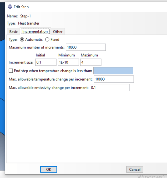

Hello I am working on LDED. there is an experimental result of the temprature value of each point that the laser touches while scanning. I am doing the same analysis with the Abaqus model. But I can't set the step. that is, the experimental data is too much, but I can't get the temperature information every second in Abaqus. I share my experimental result and abaqus model's result.
Could you hep me?
To get history output in Abaqus every second, you should set the maximum increment size to 1 s and then make sure this history output is requested every increment or every second (there is such a setting for output frequency as well).
thank you. The step setting of my model is as in the picture. maximum 4. Because the experimental run of my model took 4 seconds.
If the experiment lasted for 4 s then you should set the time period of the step (Basic tab) to this number. The maximum increment size should be much lower to capture the transient behavior properly.
