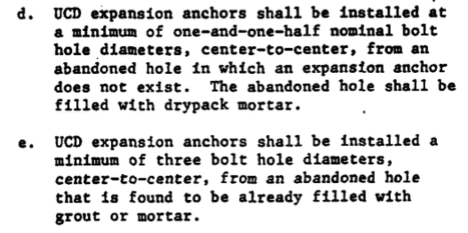

I actually worked at a plant that had a written policy regarding new anchors next to abandoned anchor holes. I'm pretty sure it was based on the study you referenced and Bechtel may have even commissioned the study for use in that plant. I'll see if I can dig up something for you.
Sorry I misspoke, the HDA-T anchor is an undercut anchor that I am using.
I managed to dig this up from that plant spec for expansion anchors. UCD refers to "undercut ductile" anchors. I can;t remember the reason for the increased spacing from a hole found already filled with grout, but I think it was because an anchor might still be in the hole under the grout instead of a fully grouted hole.
