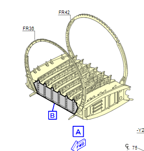

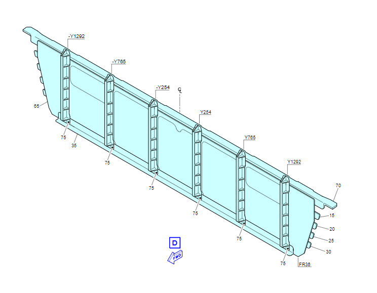

Right now I am working on a water tank installation in a A319 and I come across a problem.
For the installation, some pipes are installed and a support bracket is installed to the structure.
I can not find in the SRM or in the IPC how those items are called and if they are or not Fatigue Critical Baseline Structure.
From another drawing, that I can not show, they seem to be connected to the bulkhead floor but not to the structure floor.
Thank you so much for your help.
Those look to be bulkhead stiffeners. If this is a pressure bulkhead then it would be FCBS. Ask Airbus, they are required for define FCBS.

Finally I found what it is.
As you suggested, the items are stiffener placed on the spar of the wingbox.
Unfortunately, SRM says the whole center wingbox is FCBS and I need to calculate the newly installed bracket on it but there is already a support bracket there that I could use as a comparison for my analysis.
A water tank is already there, but the IPC does not show the exact tube diagram, so I need to investigate more.
