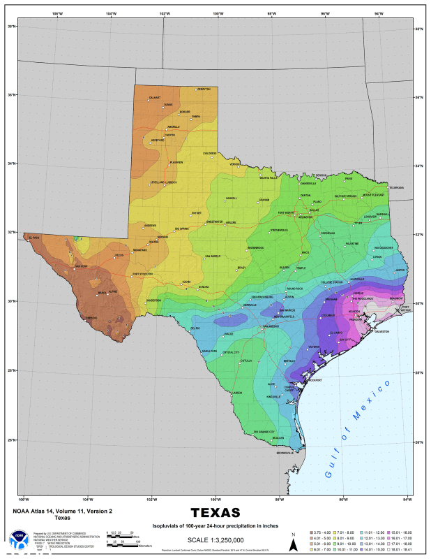

OK, so I found the data map for a 24h rainfall event with a 100 year return period for Texas.
That's probably for a Category 5 hurricane.
For Houston it is 17" per day. Please note that is total rainfall over 24hrs. It is not rainfall intensity in inches/hrs. If you want to average that you can get an average hourly rainfall intensity of 17"/24h or about 3/4" inches/hr. 0.75 x 24 = 18" of rain in 1 day. But, IMO, you cannot use that average value for anything but useless information. If you have a 1 hr rain spec, you need to find a map of 1-hour rains with the return period of interest.
