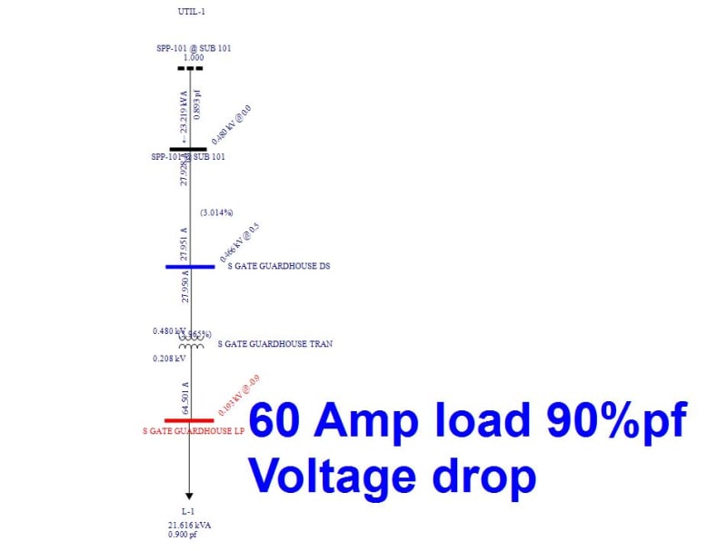

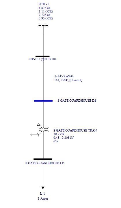

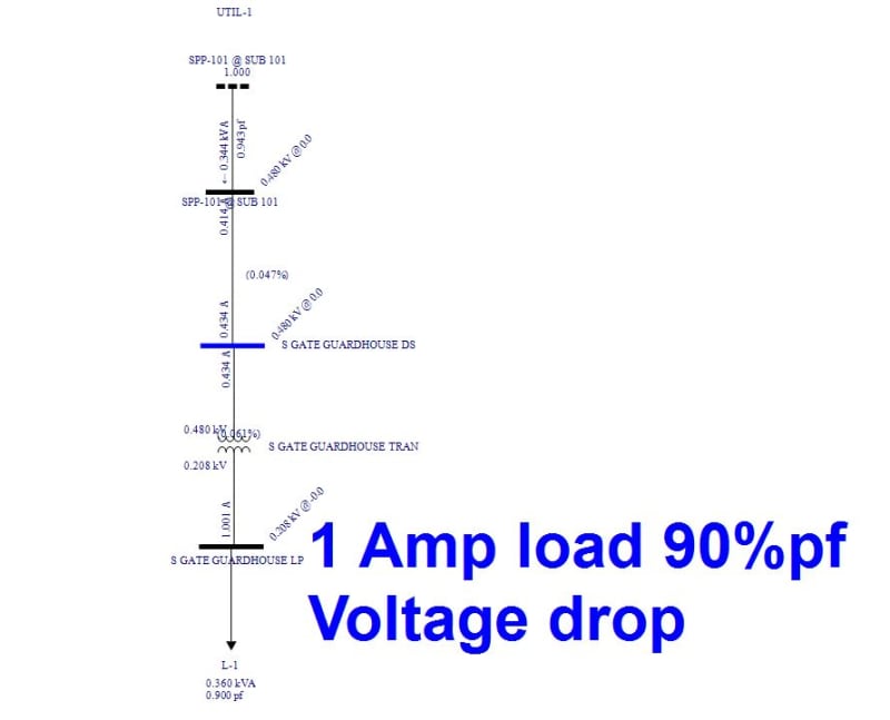

Thanks for the good answers. Just for future reference...Here is a slide of the installation I'm looking at. I made the Utility from the SC data at that point in the system.
1 amp load with a 90% power factor
And a 60Amp load 90% power factor
Calculating the Short Circuit current is simple. Just use the %impedance.
Calculating the voltage drop at a resistive load is easy. Just use the % regulation.
Calculating the voltage drop at a non unity PF, you must consider the transformer resistance, the transformer inductive reactance, the load resistance and the load inductive reactance.
The result will be somewhere in between the %imp and the %regulation.
A short cut is to use the %impedance to calculate the worst case* Voltage drop. If that is acceptable, you do not need to do the more rigorous calculation.

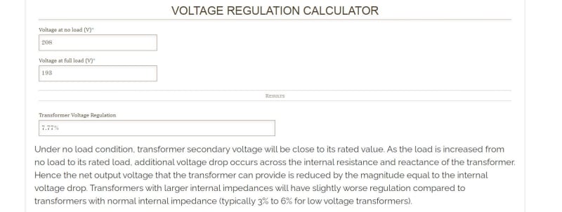

Ok based on my plots above:
Voltage at No load = 208V
Voltage at 60A ... about 75% load: 193V
(V_nl - V_load)/V_load x 100 = [(208 - 193)/193] x 100 = 7.77%
This agrees with that web site calculator...
But that doesn't agree with my book...that most transformers are between 2-4%.
That 6% transformer is not helping things it appears.
