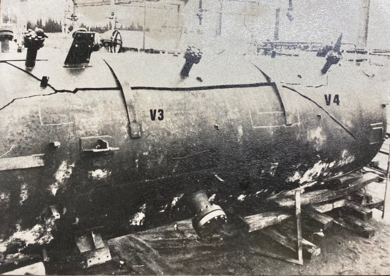

See attached pic of vessel that was in service +/- 20 years but failed dramatically under hydrotest at about 35deg F. Old picture...
Yeah I get it, but it doesn't seem as though the flanges were involved...
