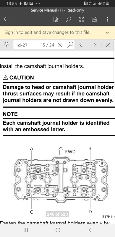

Hi, i had to take the cyl head out to fix a stripped spark plug thread. Now ive put it back on, and i came to the step for timing. I am following EVERY SINGLE step, what it says in the manual,
and i just cant get it right. Now ive got few questions, and a video with few photos to help you guys to understand what i mean.
So, my exhaust cam has a mark 1 which has to line up with the head gasket surface. It does.

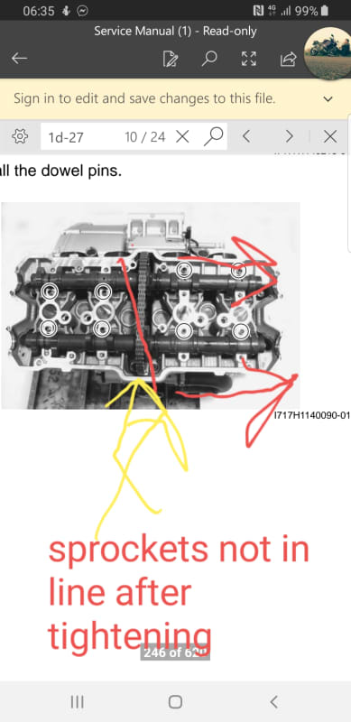

1. I cannot line up the cams (they keep getting dragged to either side when im tightening them up) which makes chain to stretch to the side and fall off.
2. Both camshafts just rotate when im tightening them up, as they are positioned in such a way, that they are opening cyl 3 exhaust valves fully.. now, the main question is, if 1 and 4 pistons are at tdc, should valves be open? I understand that they should be open slightly.

On a 4 cylinder engine, there is always going to be a valve pushed slightly open by both camshafts ... sometimes more than one simultaneously. They're going to push the camshafts around. It's normal. It also means you will not be able to "seat" the camshafts fully in the lower cam bearings ... the camshaft caps have to push them down (which will make the camshafts try to rotate).
Your video shows a totally normal condition. Just put the camshaft caps on and tighten them as prescribed.
Tighten them evenly ...a couple turns of each bolt at a time.

Also, any tips to hold both camshafts in place when tightening them down? They move off slightly which in my opinion causes the sprockets not to be alligned?
Also it says that drawing them down unevenly may cause damage.
And cams keep slipping out....🤦‍♂️🤦‍♂️🤦‍♂️🤦‍♂️
You should not have significant end play in the camshafts after it is assembled. Somewhere, involving either the cylinder head or one of the camshaft caps, is a feature intended to locate the camshafts end to end. There is nothing in that valvetrain which exerts a sideways force on the camshaft once it is properly assembled, so it doesn't take much. Look for a machined face on the end of one of each set of camshaft caps that is supposed to butt up against a machined face somewhere on the camshaft, and there is one such mating machined face in each direction. Make sure you have those parts correctly oriented.
If the chain keeps wanting to jump off the sprocket teeth, one trick is to install the tensioner before tightening the camshaft caps. Don't forget that the tensioner has to be reset (retracted) first. I've never owned a Suzuki so I don't know how their tensioners are, but between Kaw Yam Hon, it either has a bolt on the end of the tensioner that has to be removed in order to remove a spring, at which point you push a pawl down and retract the tensioner then install it and replace the spring and bolt afterward, or it has a bolt on the end that uncovers a screw head inside which you unscrew against its spring-loading to retract the tensioner, and then there is some sort of provision for holding it retracted while you bolt it down - if nothing else, you holding the screwdriver from turning while you bolt it down.

- Unevenly tightening the camshaft cap bolts. Remember that you are drawing the camshaft down against the pressure of some of the valve springs. Identify which valve springs you will be compressing ... and draw the camshaft down using the bolts adjacent to those valves first. Evenly, a couple turns of each bolt at a time.
- Overtorquing the camshaft cap bolts. It's really easy to strip them. Use a torque wrench.

One more tip - once the cams are drawn down, keep chain slack on the tensioner side. Use a spanner to turn and hold each cam; there are usually flats on the shafts for this. Do the cam furthest from the tensioner first, set it up so chain is tight between sprocket and crank. Then move to the other cam and set that up so chain is tight between the two cam sprockets. That way, the tensioner can take up the slack ready to hand turn and re-check timing.
