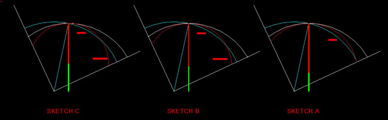

dik (Structural) 23 Feb 22 01:38 said:
... nearly matches the blue cable trajectory.
Yes, that is what I was trying to say earlier, however from a pure technical standpoint, no matter how less effective the guy wire is, something still has to bend or break before the motion can proceed. But the idea that the guy wire might become irrelevant is of concern. As I've since looked at the videos closer, I do see the structure start to lean over at the top before anything else starts to fail, at least anything that can be reconciled in the videos.
That's correct, but the cable if it's in compression will not restrain the structure to prevent it from breaking somewhere else. Depending where the elevated hinge is, the cables may be totally useless and people may have been relying on them for lateral support.
Cable in compression will allow that to happen. I got the idea from your clips, because it appeared they started to rotate with little restraint.
[pipe]
Dik, the elevated pivot point certainly doesn't help, however the red curve and white curve agree until about 10 degrees rotation, which is well past the point of collapse. I.e. it was unstable anyway.
Agreed, Tom, but the cables may be nearly ineffective, and would be less effective if there was any horizontal movement of the base to the left.

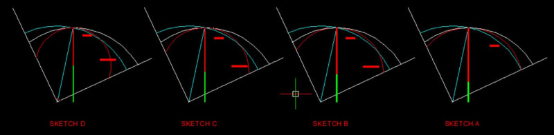

Improved sketch... moving the elevated base higher... more compression zone for the cable.

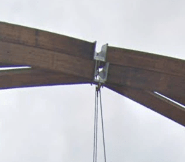

Dik, please review my first and second posts in this thread (Sym P. le (Mechanical) 21 Feb 22 00:06, and 21 Feb 22 02:07). I've been saying this since this thread started. I've just been trying to suss out the reasonableness of such an assertion in light of the many other factors that could be at play. The mount blocks for the clevis connections at the top of the arch, for instance, are either bolted in place or field welded. They appear not to have suffered any damage as they detached from the structure (see previously posted images). That is odd.

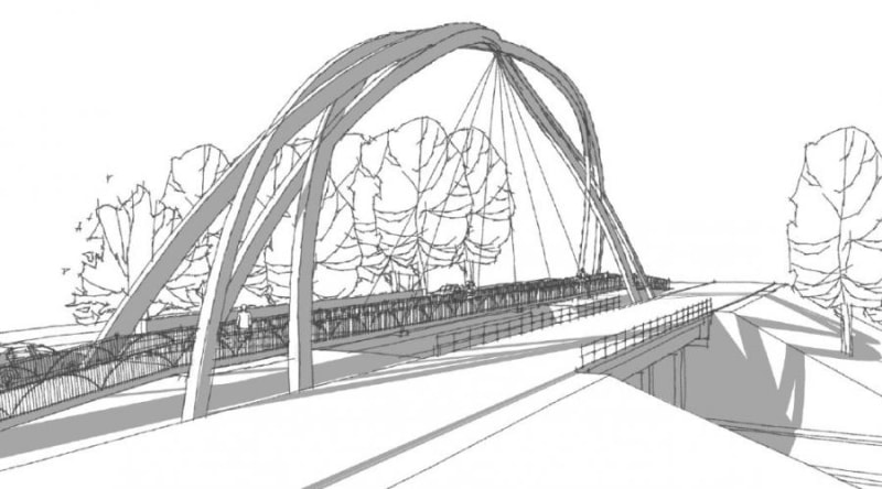

Interestingly enough, this artist render from 2017-2018 had a lot more stays...
The stays appear to hold up the walkway in that sketch. The concept must have changed over time.
Oh sh*t... I should have realised that.
If you look at the sketches, the white curve shows the approx cable location if the arches were pinned at the base... the red curve shows the cable location with the arch rotating about an elevated point... the effect is that the bracing is severely compromised. Earlier in my comments, I noted:

You're correct about the vertical component being 5x approx the horizontal component, to a point. You can see from the three sketches that because of the elevated location of the base that the tensile force may be a bit unstable. As the base is elevated the amount of leaway for tension diminishes to the point that the cables no longer provide any bracing.

I've increased the height of the pinned connection in Sketch D. As this point move upwards the amount of tension required is diminished due to the reduced difference in strain and the amount of rotation is also diminished before the cable ceases to be a tension member. This type of instability may have precipitated the failure.
We still don't have enough information to be certain of the cause; this is just another scenario. Elevating the base of the arch diminishes the effect of the cable bracing. Any movement of the base locaton to the left further diminishes the effect of the cable bracing.
