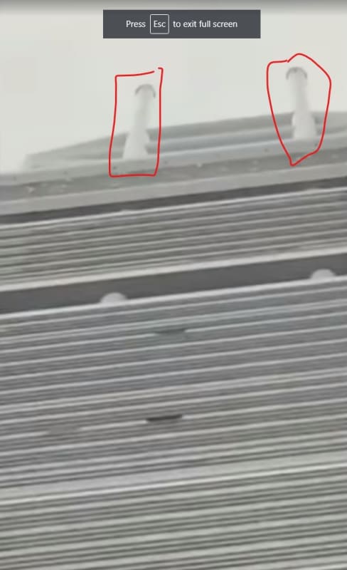

There's one video in that article where the two 'columns' below are shaking pretty good. Wonder if some vortex shedding got them moving enough to induce some vibrations throughout the building?

I have been in tall buildings which gently swayed, so I was expecting something like that, but this is a faster vibration.
There is another video showing the interior of the building, and objects are shaking with a similar frequency. There is no way those roof top chimneys could cause the building to shake; it is the other way round. In one of the clips, clouds are moving quite fast, indicating a stiff breeze. I would bet it is vortex shedding (or wind related effect) causing the building to shake. It may be specific to a particular wind speed and direction.
