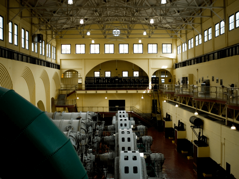

Just a little misunderstanding.
In this forum, when you say generators, this is what we visualize:
