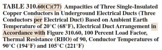

You are correct! Based on NEC 250.36B, the grounded system conductor shall have ampacity >= resistor current rating, which is 350A. The question is, which table to use?! This would be single conductor, 5KV, insulated/shielded cable in underground PVC conduit. I think the closest table from NEC would be Table 310.60(C)(77)(Detail 1), but like all tables in NEC, this is for (3) conductors in electrical duct. Anyone know of more applicable table for this application?

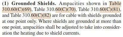

Thanks wross! This section from NEC I'm looking at looks like this:
For 250 MCM (90 degree C),2001-5000v, single duct, the ampacity is 320A corrected to . I may have to use 2-1/C #250, since that's what I'm using for the phase conductors.
With regards to shield, this is what it says:
So, this only applies to "Insulated single conductor isolated in air", and "single insulated conductor directly buried in earth" for some reason!
Shield current resulting from grounding at more than one point adds heat to the cable no matter what the installation method.
