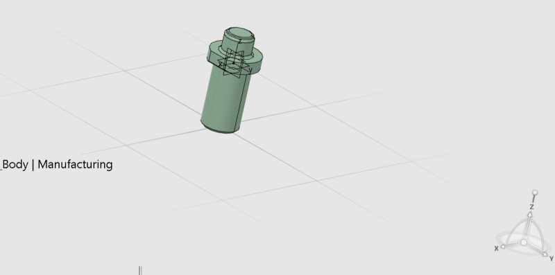

If you choose "Ambience basic", you can change the background the way you want:
