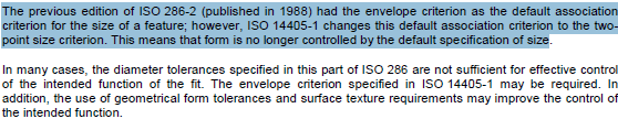

I have one additional follow up question (in top of the previous one related to circularity)
If the drawing states :
"20.0 H7 +0 / +0.021" for size and ISO 2768-mK
(no ISO 2768-mK-E and no ISO286-2)
then how do we know if envelope requirement is default or not?
What are the factors that tell us the envelope requirement is enforced?

When it comes to the allowable amount of circularity tolerance, I don't see any difference too. In both cases the maximum allowable circularity error is 0.021 because this is what ISO 2768-2:1989 explicitly says in para. 5.1.2 (see my previous post).
There is, however, a significant difference when it comes to the size of the worst-case envelope that the feature cannot violate.
In the 'ISO 2768-mK' case, that size is not determinable. Although one can find the extreme sizes of the enveloping circles in individual 2D cross-sections according to the illustration below (caution: the illustration is for a shaft, not for a hole)...
... the size of the enveloping 3D cylinder is still not determinable.
In the 'ISO 2768-mK-E' case, the size of the of the enveloping 3D cylinder simply equals to MMS (Maximum Material Size), which is 20.

Your question helped me realize that by saying that in the "ISO 2768-mK" case the 3D boundary is not determinable I made a really simple mistake. I just forgot that ISO 2768-2 defines general tolerances for straightness. [hammer] My apologies.
Having said that, I think that for circularity you would just have to use the size tolerance tolerance value, and not the size tolerance value increased by 30%.

Per pmarc looks like ISO had a very serious configuration management issue
Pmarc,
Do you know if this issue still exist or has been solved in the meantime, with the new revisions of ISO286-1 and ISO286-2?
