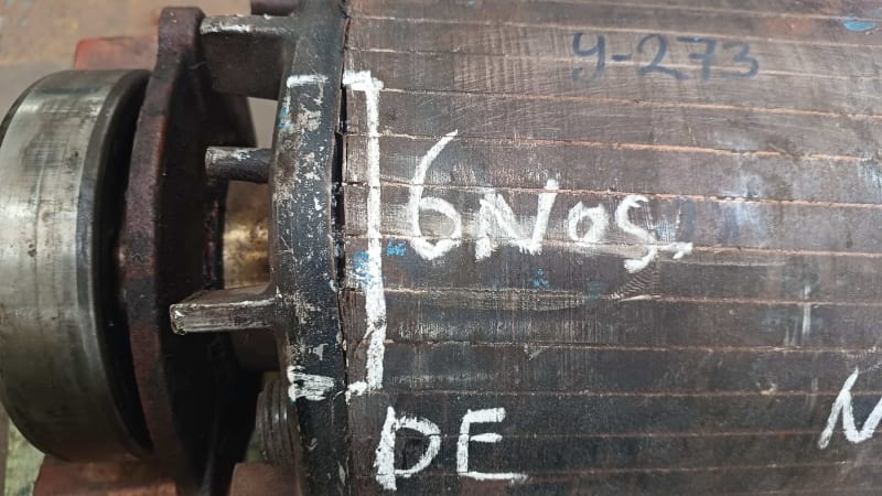

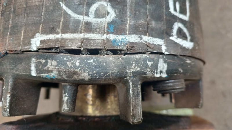

Today, our repair shop received the following crappy chinese 16 KW, 6 pole high slip (13.5% slip, probably NEMA D motor) Al die cast rotor with six bars broken clear of the end ring. High slip means higher rotor losses and higher rotor temperatures. Melted Al sprayed over the stator winding and killed it too.
Customer complaint was the motor was running slow and taking high current and then tripped on OL. That rotor is toast.

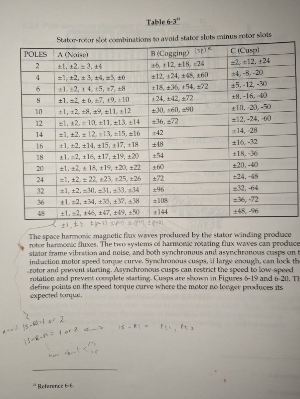

See figure below from EPRI 5036 Volume 17 (a very useful reference imo and also available for free).
Each row corresponds to a given number of poles P given in the left hand column.
The right hand column "C" represents "cusps" which are identified elsewhere as cusps in the torque speed curve that may dip below zero (I interpret that as crawling)
The entries in that column C are not all the same, they change depending on number of poles. Relevant to the current discussion, the table entries in column C for 2 and 6 poles are different.
for op - The figure also tells us in advance what you might be looking for (when you find out stator/rotor slots) to cause cusps/crawling for the 6-pole winding. Difference in rotor/stator slot combination of 5 in either direction, or else rotor bars exceeds stator slots by 30 (rotor bars exceed stator slots by 12 would also be problematic, but it would be problematic for both speeds). I would recommend you make that count on at least one of these failed-start motors.. either ask your repair shop to do it, or else ask your own maintenance staff to do it

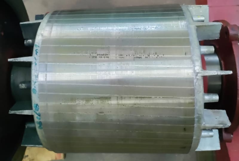

Below is the original good rotor of an unused spare motor received today.
I think the rotor bars started failing due to high slip (high rotor loss) and frequent starts (high inrush currents).
