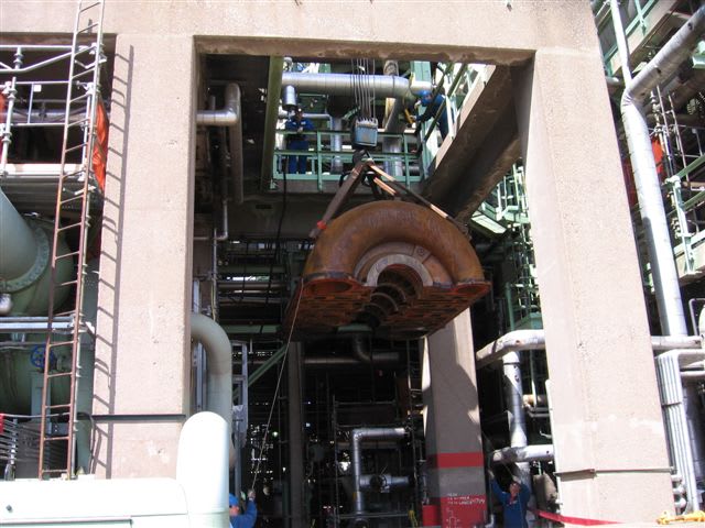

We make lifts like this all the time lifting compressor and turbine covers much heavier than your piece. I would normally rig them to lift from four points. I would design the rigging so that any two of the four legs could take the load with an appropriate safety factor. I would pick it up and check for level. If it is hanging level enough for the need, I would proceed. If not, I would add chain-falls as needed to level the piece.
Since you have already installed the two additional lugs, you could pick from those two lugs and add come-alongs or chain-falls to two corners to level as needed.
This compressor cover weighs 30 tons. We picked it with four matched straps to the four corner lugs.
