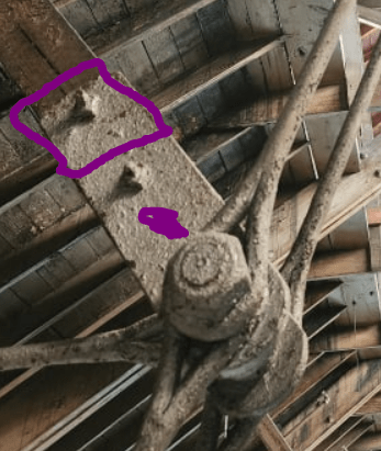

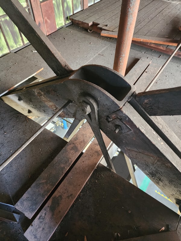

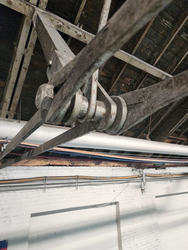

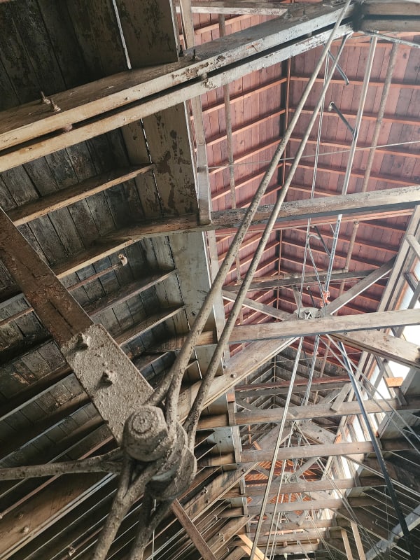

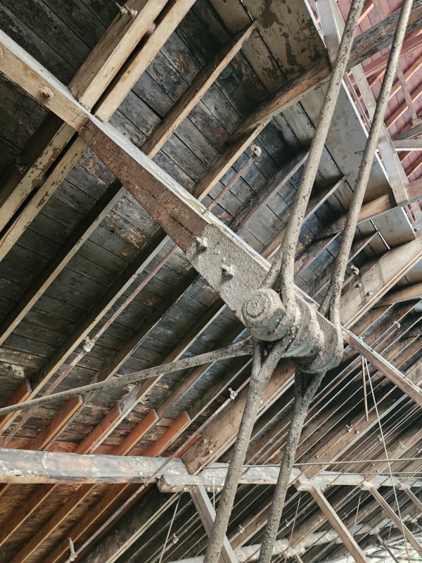

I'm trying to analyze a wood and steel bar roof truss built around 1870. Obviously A36 steel wasn't around then. I'm not even sure A9 steel existed. Does anyone have an idea of what kind of material properties you would use for this?
Can you post a picture? You may be looking at wrought iron.
sure, here are some. The bottom chord are these 2"x1/2" flat bars. The web members are 7/8" or 1" round rods
Just to throw this out there but if this is a situation where exact material properties need to be known rather than general ballparks (e.g., analysis shows could be real close) then you need to do a few coupon tests of the material in-situ.
This is also really cool. Thanks for posting the pictures!
Enable - how would you propose doing coupon tests on those members?
I'd determine which areas are lowly stressed and look at obtaining representative samples from these areas. I cut the material with a saw and not with a torch. It would help to locate a good testing company and have them review the locations and the samples.
You see...it's easier for me to say from afar what to do. Didnt say I would know how to do it!

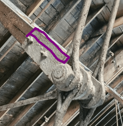

Ideally we get a test from every type of member but based on the pictures it looks like the webs are out unless we have some spares kicking around. So as a first go (more may be needed later) I would suggest cutting a section of the plates and then having a plan in place to restore capacity at the cut. Would take a bit of work because assuming non-weldable steel you'd have to do some through-bolting or other mechanical fastener through new/old plates. Also may want to put some shoring up until retrofit plate is added.
An alternative thought is that if those posts are our compression members (seems likely) and there is a nice plate or transfer mechanism at the base those bolts might not be very stressed at all. In which case we would probably still do *something* as a retrofit to take the sample but probably don't need to shore it.
Option 1 take a long thin cut leaving both bolts in-tact. Add new plate / screws prior to doing so (bolts look like they have decent thread).
Option 2 add another through-bolt below first one and cut above.
EDIT - Also we should probably get some bolts back to the lab as well. So replace a few with A325 or what have you.
Leaving out the rods wouldn't work - they are a completely different material. More than likely (based on my initial assumptions and that book I linked to - check it out, Enable...I'm thinking of buying the reprints of all 3 volumes), the rods are wrought iron and those shoes on the wood compression members are cast iron.
I'd prefer to leave them in place and just not change the loading on them, but if that's not an option (snow, change of occupancy, etc.), then I'd say shore up an area and take apart one of the trusses and test the components. You'll have to rebuild at least one truss - if the results come back and it it's no adequate then you'd have to replace them all anyway. Not much you can do to 'reinforce' a truss like that.
Thanks for the book suggestion! Figure 41 is almost the exact view of the actual truss, and the eye detail of the flat bars looks just like what's there. Based on that then, I'd say you're right that they're wrought iron.
I don't know about the shoes at the ends of the web members, but the shoe at the very peak looks almost certainly like cast iron.
