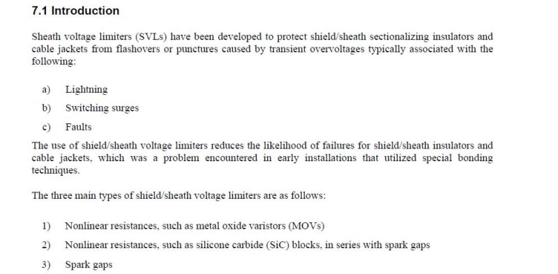

At a local industrial site they have a set of 30 year old 115 kV single conductor cables terminated using potheads. The shields at the source ends appear to be terminated to ground through a carbon air gap mounted on the cable support structures (see attached photos). Can anyone confirm that the function of these these devices is to act as a spark gap in the event of a surge or fault to the cable shield? The cables are several hundred feet long and I imagine the normal operating voltage at full load would be quite high relative to ground on the cable side of the gap due to induced voltage.
If the shield is grounded only in a single point the shield induced current is limited-in order to limit the cable heating-but in the same time a build-up induced voltage could be very high and in this case at the second end of the cable the shield is grounded through voltage limiters. See IEEE Std 575/2014 chpt.7 Sheath voltage limiters.
