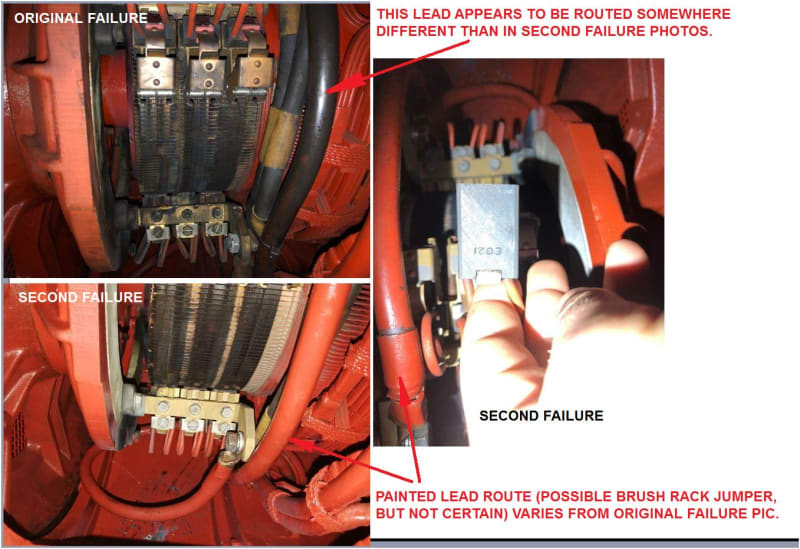

Hello all, please bear with me as I am a first time "poster" here.
I'm an electronic engineer and not used to service DC drives or DC Motors, I service mostly Servodrives and VFD for AC Motors.
I had a job to service a SIEI Typact TDP3 SCR Drive for a system that is driving 2 german 110kw CONZ Dc Motors in parallel on a Ship-port crane.
I serviced the Drive and another Company made an overhauling on the 2 Motors.
On the first test run one of the motors had a massive flashover.
Testrun was made with no load on the hook and gradually increasing velocity in one direction and then in the other to about 50% of the maximum joystick position.
Motor went back to the company and returned to be tested again. On the 2nd test run the same motor did had a flashover again, but this time the pattern looked as the discharge was to the frame of the motor.
I asked the motor company about what could have been wrong with the motor and they told me that on the first test run the where to much humidity in the motor.
And on the 2nd time there told me that the motor was pushed to hard and went in over-speed.
I have just a basic understanding about Motors, so I can't argue with the motor company, but I may accept that on the first test run a high humidity could have let to a flashover. But telling me that I had pushed the motor to hard on the 2nd test run is not plausible, because I have 1 Drive controlling 2 motors in parallel, each motor driving 1 cable drum each, and each cable was pulled the same distance.
I had no change to inspect the motor on the 1st time, but on the 2nd time a had a look at the brushes and I'm quit sure that they wasn't settled in on the commutator.
Also the pressure of one spring was very loose.
Could this had caused the flashover ?

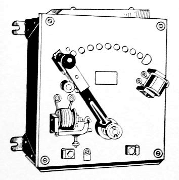

When a DC motor was started on a bus or full voltage DC supply the operator stepped the motor up trough the starting steps manually.
Series resistors were used in the armature circuit to limit the current and where cut out in steps.
A manual DC motor starter may look like this:

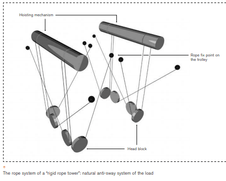

I purchased one crane with the anti sway rig similar to container cranes. All 8 ropes landed on the same hoist drum. Similar to this rigging Kocks uses on their terminal server cranes, except all of the rope is on one drum.
With two drums and no mechanical linkage I would prefer two encoders, one is reference hoist drum current position, the other is on the hoist drum that is speed trimmed, connect the two encoders to a compere, and use the output error signal to trim the speed on one of the two motors.

There still is a problem. As the motor came back from the shop to be mounted on the crane we tested it and it only took 30 seconds to develop a flashover again.
This time we swooped the position of the 2 motors to be sure that there where no mechanical problem with the gearbox or the electrical cables from Drive/fuses/resistor/exciter to the motors.
I had several meeting with the company in charge of the repair of the motor, and tried to hand over the informations that was given me on this forum.
They always denied that the connection could be wrong and as I asked for a test report with full load, they told me that this was not necessary because the have a lot of experience and it was never necessary to carry out such a test/report. So I was quite sure that the motor would fail again and it failed.
I was monitoring the current of the armature on both motors, there was a slightly difference of the current 1-2 Amps less on the "good" motor. There was just very little sparking till the current hit 90A - 100A, after that the flashover. It was very fast and I had no time to switch off the drive fast enough, and even I don't know if it is safe to disconnect a DC Motor abruptly.
The damage is an exact 1:1 copy of the photos of the second time the motor failed.

At this point you may be better to check the connections yourself.
I would first try using a hacksaw blade as a magnetic polarity probe.
Put a low voltage DC across A1 and A2.
That is the armature circuit including the interpoles.
Use a short length of hacksaw blade and a compass to probe the polarity of the armature field and the interpole field.
Compare the good motor with the bad motor.

Thanks for the update. Load tests are expensive, that's why it's only a type test even for OEM's. As a rewinder, I do no-load tests only for 99% of the jobs.
As I said before, there are other ways to test the DC machine connections without doing the load test. The repair shop is either unaware of such tests or is being just pigheaded.
I am more positive that in your case, the interpole connection is wrong since the flashover is happening only on load.
Muthu
Celso, it was an excellent idea to swap the placement of the two motors to confirm the integrity of the electrical / mechanical installations, etc.
Acknowledging that load testing a Direct Current motor is not possible in every repair facility.
Numerous other tests can be made however on a motor before re-assembly for assurance the repair is proceeding without errors.
Voltage Drop tests on the interpoles and the field windings are very important steps in knowing the condition of the apparatus.
These tests are performed during disassembly and original inspections however. Not as an afterthought during re-assembly.
And marking, tagging the all important leads to the brush rack is extremely necessary for everything discussed so far.
Having looked at the original posted photos considerably longer than I would normally do for an Internet forum,
I keep returning to the three pictures that show a lead route going and coming from a different place.
Brush Rack jumpers are not very long typically, and are normally just long enough to make their respective connections.
I think the motor is connected improperly. None of us reading this forum can prove the connections though, and there is always a chance
we are all wrong in our hypothesis because we are not in the motor's physical presence.
Repair history on the motor is becoming a little foggy. Another factor to remember is repair shops can make the mistake of unknowingly
following someone else's errors.
Again, I'm wishing you success in navigating your nightmare.
John

John, you nailed it.
Finally good news, after some investigation, today I discovered that there is a 3rd party evolved in this process. The 1st motor overhaul was made by the company hired by my client and this company has lack of experience with DC motors.
2nd and 3rd overhaul was made by a well know company in my country, but they failed to do it right because o the first overhaul someone did change the interpole wiring.
As I only was talking with the 1st company, for sure they ignored my information about the interpoles and didn't pass the info to the 2nd company.
Today at the 2nd repair shop a load test was made and wiring was checked to be wrong. At 60A motor was sparking and after interpole wiring change motor was running fine.
