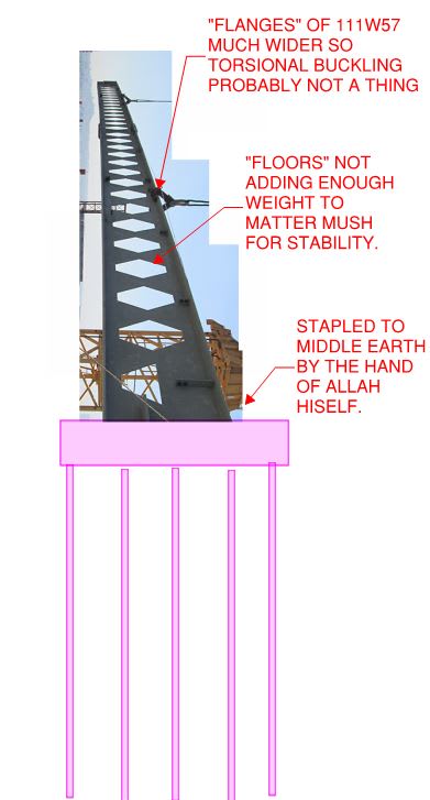

In my mind's eye, I see the building much like this.

What's interesting about these buildings is that the structural engineering has enabled a new business model. They can build a large amount of high end space on small lots and sell them for high prices. Its quite different from the structural engineering being treated as a secondary service as it is frequently.
Technically, its all about the dynamic performance. Tall buildings have very low natural frequencies, so aeroelastic performance is important. Also allowable accelerations can be hard to pin down. I think the wind engineers RWDI deserve as much credit for the structure as WSP.

These structures do not need damping for strength, only for user comfort, so no TMD's are required during construction.
The amount of sway they can sustain strength wise can be quite gigantic - we worked on a 70 story building in LA which swayed +/-30ft in a seismic event.
