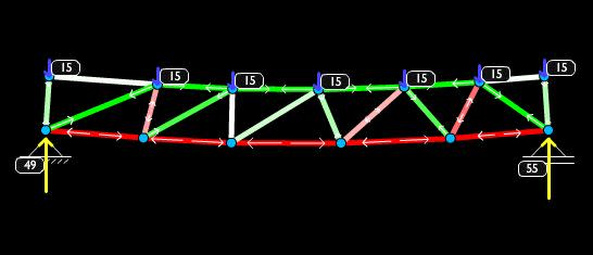

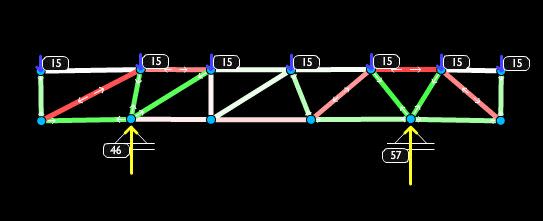

Just in case anyone is interested in a rough idea of the tension / compression loading of the trusses when:
A-In transit supported underneath in 2 places mid span
B-In Situ supported at either end of the span
These are not to scale or necessarily accurate, but give a general idea. Draw your own conclusions here.

Member 11 may have been a tension member during construction but it was a compression member after the temporary supports were removed. Assuming a total weight of 950 tons, the bridge reaction at each end would have been in the order of 950 kips under dead load only. Member 11 appears to be oriented at about 35o to the horizontal, so it would have been loaded to about 1650 kips, a compressive stress of 3,300 psi on a 24" x 21" section under dead load only. It did not need any prestress at that stage.

Nobodyimportant:
Your arrows are drawn to show the forces in the members and not the forces at the panel points; is that correct? Nice drawings...
And add to that the forces induced by the 'fake' cable stays, it gets more interesting. These additional forces should be included in the design for the blocks at the tensioning cable intersections.
Just because the cable stays are fake, doesn't mean they don't take load or influence forces in other members.
Dik

Just a rough average spread of weight across the span to give a rough view of either tension or compression in both load scenarios.

Does anyone else not like the V shaped profile under the deck, and the SPMT using quite narrow wedge shaped load spreaders on top the shoring?
Hope they loaded it in the right places too, that truss arrangement has some significant load complexities.

Nobody important - This was one of my concerns, particularly after re-watching the the full length bridge move & the pause, that took place. Driving over the center divider did tilt the bridge. Reading up on the SPMT vehicles, some of them are built with telescopic axles to accommodate uneven ground. Still, it has to be done correctly.
That (rough) compression-tension FEA sketch is logical, and explains how the top members are in great compression across greater length/limited thickness elements = classic buckling failure at the odd-angled connections of each member that is in compression. But - Why would the "missing" center vertical temporary vertical pier NOT be installed?
Does the analysis/design team truly think that a cable-stayed bridge only needs the cable stays and central pier for "looks"?

Quote (BAretired)
At that cross section and length, how stable would that member be against buckling?

One possible explaination...,
RE: Miami Pedestrian Bridge, Part II
Why would a crack form in an area that is under considerable compression both from the PT tendons and the overhanging load?
The distance between the canopy and the deck remains constant at #10, while outboard of #10 they both hinge together.
