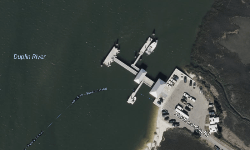

It's the long rather slender walkway going out to the outer pontoon.
Sounds like there were about 20 people in it, mainly elderly waiting for the ferry.
Not clear what the failure is, but looks to have collapsed in the middle. Only a year old apparently

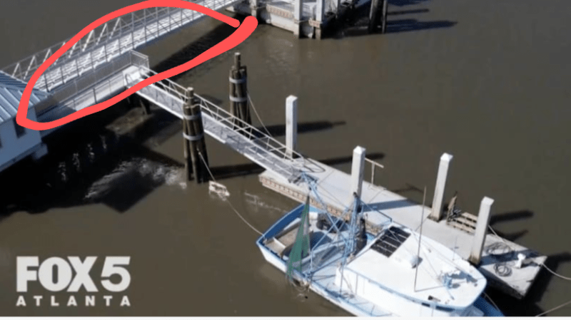

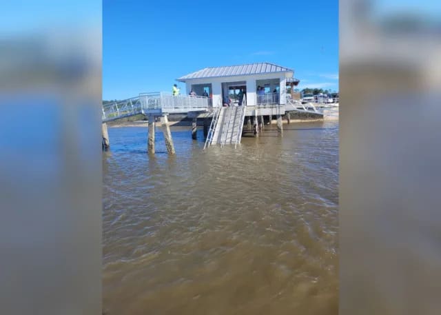

For clarity, it wasn't the gangway that failed. It was this span.
I call that a gang way...., but yes it's that bridge / span between the floating Dock and the Duke m fixed height.
Anyone an idea of the state of the tide at the time of collapse??
I agree, a gangway. One end is hinged to the shore and the other end follows the dock as it goes up and down.

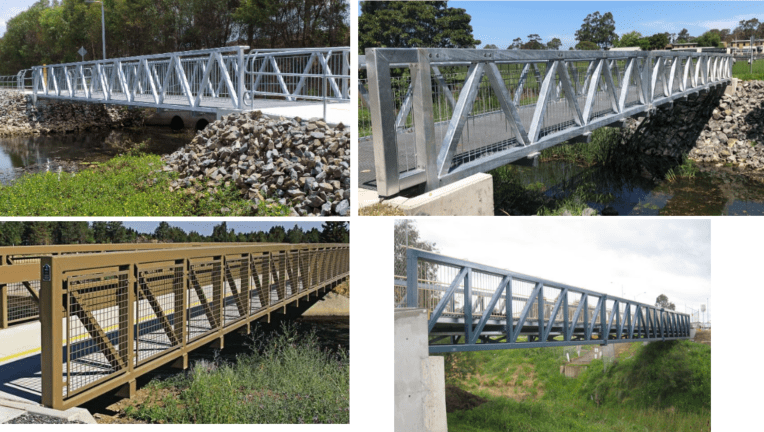

From what I have seen, it is very common for pedestrian bridges with ~20m/60' spans to have a top chord of a 150mm/6" or even 200mm/8" steel square hollow section.
Comparing this to a 100mm/4" aluminium tube, the bending stiffness (E*I) could be up to 20x more for the steel square hollow section. Examples below:
I admit I'm not familiar with the requirements for gangway loads, probably they are less onerous than for bridges, but maybe someone can enlighten us.
