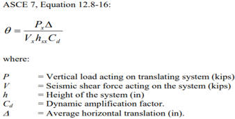

Flexible diaphragm deflection doesn't necessarily have a hard limit as far as I'm aware (whereas overall building drift limits have hard limits), but there are other considerations such as P-delta effects on the gravity and lateral systems. See ASCE 7 "Stability Coefficient". Another consideration is building separation when you have buildings located close to one another.

One simple method to evaluate this concern is through the stability coefficient, θ, of ASCE 7-10 Section
12.8.7. Although this stability coefficient, θ, was not originally intended to be used to evaluate
diaphragm deformations, with some simple adjustments it is a useful tool to investigate the diaphragm
system stability under P-Δ effects.
This equation evaluates the relative magnitude of the horizontal load added to the lateral force resisting
system at the system’s maximum expected deformation. An increase of 10% or less (θ ≤ 0.10) is
considered tolerable under ASCE 7-10 without a more detailed investigation.
The vertical gravity load acting on the translating system, Px, has a component from the roof weight, Px
roof, and a component from the wall weight, Px wall. As indicated by the applicable load combinations, the
roof live load is excluded from the weight of the translating roof system. Because the wall’s center of
mass between the roof and slab on ground is only translating approximately half of the roof’s
translation, the Px wall may be computed as the upper half of the wall plus any parapet. The load factors
are 1.0 for this investigation.
