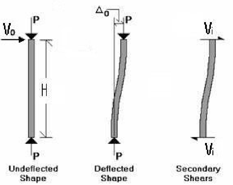

You've posed a really good question. I don't think there is a simple answer. Maybe someone has a better idea than I do. But, I would probably do the following:
Look at the image below (which was from a presentation I did maybe 15 years ago).
Vo is whatever lateral loads you originally applied.
P is whatever gravity loads you originally applied.
Delta_o is the initial elastic deflection that results.
H is the height of the column.
The only difference is that you would amplify the Delta_o by Cd so that the secondary shear is really.
Vi = P*Delta_o*Cd / H
Then I'd apply this Vi (for a LINEAR analysis) in combination with my regular loading.

Yeah, that would probably work. If your software allows it. I was assuming that your software didn't allow anything so advanced.
