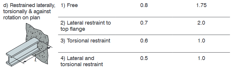

Understand that 2L is often correct ... for the case with a cantilever with a fixed base (restrained laterally, torsionally and against rotation on plan), AS 4100 agrees with BS 5950-1/SCI P360. See below from P360.
But the case mentioned initially, for continuous beam with partial torsional restraint, an effective length of 7.5L compared to 2.0L is a big difference.
In AS 4100, the code "PU" infers partial restraint at one end and unrestrained or free at the other end.

See AS4100 commentary. Chapter 5 rules are for ideal cantilever support only. Rigid for all rotation directions. Cases C1 and D1 from the AD408 document so AS has similar effective length. Never used them but Appendix H has rules for other cases. BS seems much simpler.
@Human909 Cabtilevers are considered by AS4100. Look at last 3 rows of Table 5.6.1. Also can use general equation for moment distribution (a.m factor) for beams with vertical support at one end but no restraint for buckling.

Just to be clear, regarding last 2 posts, the case considered is for beam overhang past another member with and without partial rotation restraint (and with load at top ... destabilising). The effective length is 5.0L and 7.5L respectively from BS 5950-1/SCI P360.
AS 4100 will give 2.0L with partial restraint and "no guidance" without partial restraint.
So AS 4100 is unconservative here.

AS gives >2.0 for partial restraint. You're ignoring the kt factor. Say 2.2-2.4 as a guess. BS goes from 2.5 full restraint to 5.0 partial restraint. That's conservative for UC section. If in doubt make it stout stuff. BS picks one number for UCs UBs and plate girders. Don't pretend it's accurate.
The 7.5 case is unrestrained in AS simple method so not unconservative compared to BS.
AS gives Appendix H as something you can still do by hand. But buckling analysis is prob easier these days. AS also covers this.
AS had the same as BS in the.working stress days. Conscious decision to switch.
Edit: Remembered wrong. Top flange factor was only 1.2 in the AS working stress code. Shear centre was same as BS.
