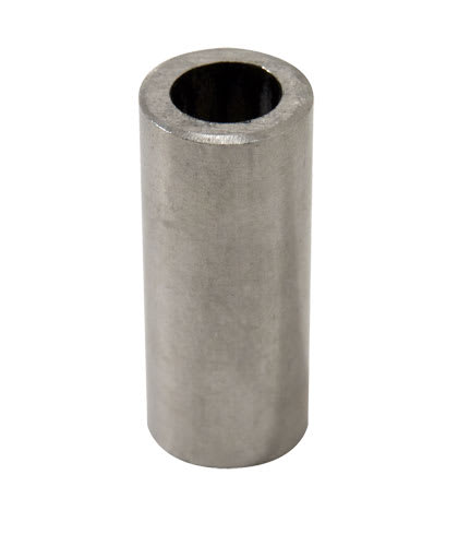

How the spacer's dimensions i.e. Outer diameter and thickness (Inner diameter) used in bolted joints, are determined or is there a standard/recommendation for the sizes of the spacers with respect to bolt size.
Any reference to the technical literature/book is highly appreciated.

Thanks for your time for the response. The spacer is a cylindrical part used between bolt head and first member of the joint to increase the length of the bolt, where clamped members are not thick enough for a proper Joint and Bolt stiffness ratio.
The washer is used between Bolt head and spacer upper face.
My original post was to get help regarding the spacer's dimensions with respect to bolt size, that is the spacer inner diameter (clearance hole for the bolt) and the outer diameter of the spacer, these dimensions determine the contact area of the spacer with the member/flange of the joint.

This not a washer, it is used to set a distance between detail parts.
And it depends on the material compressive strength.

This appears to be a different application. The part shown by the op
Is much smaller diameter spacer.

That spacer looks like a liability. Unless it is DOM tubing and a pretty good analysis conducted, it seems like it could buckle or rupture when used in conjunction with high strength bolts.
There are good reasons to increase the length of a bolt in some joints.
An alternate way to get many of the same benefits is more smaller diameter bolts in place of few big diameter bolts.

Those spacers do look a bit odd. If they are that long you will start putting your bolts into bending.
