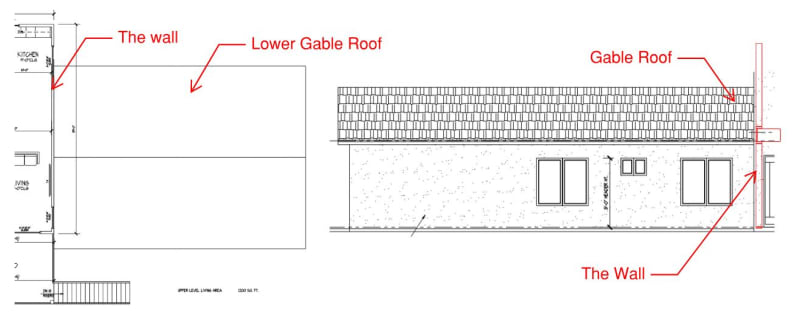

Hello everyone,
I'm currently working on the structural design for a T-shaped timber building located in seismic design category E. In this project, a one-story portion of the building intersects perpendicularly with a two-story portion. The challenge I'm facing is that the wall between these two portions doesn't align with the end truss of the one-story portion and extends upward to reach the higher roof of the two-story section.
I'm trying to determine the best way to transfer diaphragm forces from the end truss of the one-story section to the shear walls of the two-story section, despite this misalignment. I'm considering options like adding two layers of wall: one to align with the end truss of the one-story portion and another that extends up to reach the roof of the two-story portion.
I'd appreciate any insights, details, or resources that could guide me in the right direction.
Thanks in advance for your help!
I don't practice in seismic country, so don't shoot me if this isn't allowed for cat E, but I'd do away with the last truss and use a ledger fastened to the wall to catch the roof sheathing. The fasteners (preferably screws to each stud) would be sized for the gravity load and the shear transfer into that wall. You may need to specify the wall sheathing to run down past that ledger and fasten through the sheathing to make sure you have a good load path.

I believe the gravity load will be carried by the ends of the truss through the side walls, so considering only the shear forces of the roof diaphragm for that ledger should be sufficient. This is also my first project in such a high seismicity area—the Sds value is 2.02g!
I disagree. Load follows stiffness. If you forgo a truss against the wall and only do a ledger, the load must go through the ledger. If you keep the truss but fasten it to the wall at each stud, the connections at 16" o/c will be much more stiff than a truss spanning 20 or 30 feet, and the load will go from the top chord straight into the studs.

could you make some sketches? I'm all for ledger transferring shear into a wall but it sounds your describing a more complicated scenario that may include discontinuities.
I hope it helps.

I seriously doubt you can design this to "slide" against the wall as a three sided diaphragm in SDC E. So there's not much choice.
Generally the shear force into the wall would involve half of the wall weight, plus the roof weight. The bottom half of the wall seismic force goes into the sill connection at the base and the soil/foundation.

You could use a ledger over the shear ply. Make sure you have enough fasteners to transfer your diaphragm shear.
The shear wall with the ledger attached now resists the shear force reaction from the diaphragm. This shear is in addition to any other loads coming from the 'taller' part of the structure.
