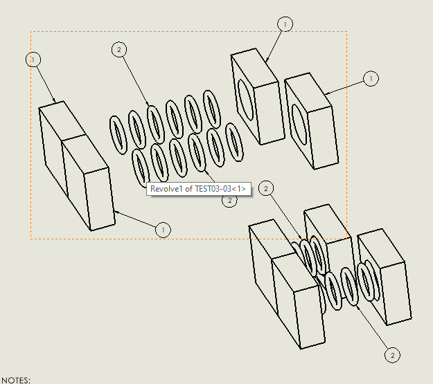

What I am actually doing is more complicated than this, but this illustrates the problem. Here, I have two views of the same assembly with two flexible coil springs. Note how I did not model the hard-to-render helixes (helices?). In the exploded view, the springs are shown not-flexed. In the lower view, they are flexed separately, but they report the same item number. So far, so good. I have designed all sorts of optical fixtures in the past that used coil springs, so this is very cool.
My problem is that I want to array the flexed components, in their flexed state. If I do this, the arrayed parts will be not flexed. I can make each and every piece flexible with constraints, but I don't want to do this with say forty eight parts. Also, I want to edit the assembly and change number of arrayed pieces.

No. That is not how Solidworks works. Solidworks is a database software based on items. For your springs, there are two items or states (free vs compressed).
What is your item #2? Is it a part model with 6 "donuts" (bodies)?
If your spring has two states, you can make them with two configurations. You can make it either a helix spring, or a bunch of "donuts" as you did.
You don't need to array the flexed components. You just need to make one part with two or more configurations.

The drawing is mine, off of my 3D[ ]model. I am showing donuts because I don't want to model helixes. Helixes slow down updates. The parts are coil springs, and they have only one configuration.
SolidWorks 2021 has some capability to model flexible parts. It takes some fiddling to set up, and logical documentation is tricky, but it works nicely in the views shown. I just can't array them.

What you are trying to do is not "Flexible" components. I think you want to make "smart" components that are driven by your assembly mates. If you make your springs with "top down" approach (instead of bottom-up approach), they will behave the way you want. The distance (or pitch) between "donuts" can be controlled with an equation.

Look up SolidWorks flexible components. I have only one configuration of the spring, and there are no variables. The length at assembly time can be controlled by the assembly. In my figure above, I have two instances of the same spring, i.e., the quantity on my BOM will be two, in spite of the springs rendering to different lengths on the assembly.

If you have a part file with single configuration, you can't make it to have two different lengths in the same assembly environment. Your spring is driven by a single input from its parent assembly, but not both.

I just did a test. "Flexible components" is an assembly feature (or an over-write in laymen's term). Currently, SW component pattern command does not support the flexible feature in an assembly.
