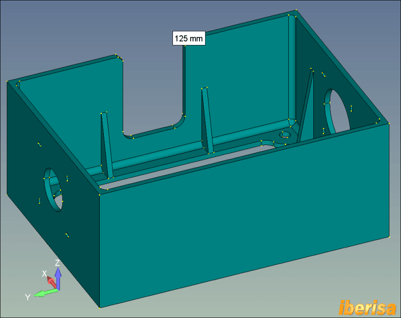

I am encountering an issue with FEMAP. When I export a model to a STEP file and save it, the scale of the geometry seems to change when I open the newly saved STEP file in FEMAP.
This issue also occurs when I try to import and merge the saved STEP file into an existing model.
The original geometry is in millimiters. The export should remain in mm, but on import to another FEMAP model, it reduces in scale by 1000.
We've checked the preference settings and explored all other available options, but we haven't been able to resolve the issue.
Does anyone have any recommendations for how to address this problem.

I have tested the issue but at my end FEMAP is running correctly, so is a local problem related with your geometry, probably you have in your FEMAP model a mix of solid parts with different scale factors, list your solids using command LIST > GEOMETRY > SOLIDS, you will see something like this:
Code:
List Solids
1 Solid(s) Selected...
   Solid          1 - 1                                                                                 Address: 34022  Scale: 1000.       Type: Solid
I base my comments in the following:
1.- I have imported the STEP file located in the FEMAP EXAMPLES directory that every FEMAP user have in the computer: mp.STP
2.- I see the thickness of the ribs & walls is 125 mm (I run solid scale factor = 1000, ie, millimeters).
3.- Edited the geometry model, for instance the radious of the holes.
4.- Saved in FEMAP V2406 and exported again as STEP file as mp-rev1.STP
5.- Imported the new STEP file in a new FEMAP model, and the thickness is correct: 125 mm
Please post your FEMAP model here and we can investigate to see the real reason of the error, thanks!.

Hi Blas,
We've sort of resolved the issue. The geometry imports fine on one of our computers, but not another with seemingly exact same preference settings.
Our FEMAP supplier technical support team suggested we export the geometry from the computer that is fine as a parasolid (not a STEP) and then re-import into the faulty computer. They believe it is a bug within FEMAP since version 11.
He also showed me the Tools>Convert units function which I was unaware of until now. Is very useful.
We can't really share the geometry with you as it is client sensitive. I will however try to find some other geometry that has the same issue. Could be some time tho.
