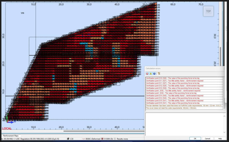

I don't use Robot structural analysis. Can you share what the issue so we can provide some guidance?
[EDIT]
I am currently looking at the image. How many storeys do you have? The raft looks huge for a school project. What is your soil bearing pressure? What are your column sizes and what is the building being used for?
S10(S26) - The value of the punching force is too big
It is either your raft isn't thick enough of you've a higher load (more than actual load due to typo or something)
S11(527) - Too little safety factor - reinforcement required
Is your raft unreinforced? Note that you will be both top and bottom reinforcement. Also check the factor of safety you're using. School projects, you can get away with 2.0. But if values were provided, use those.
