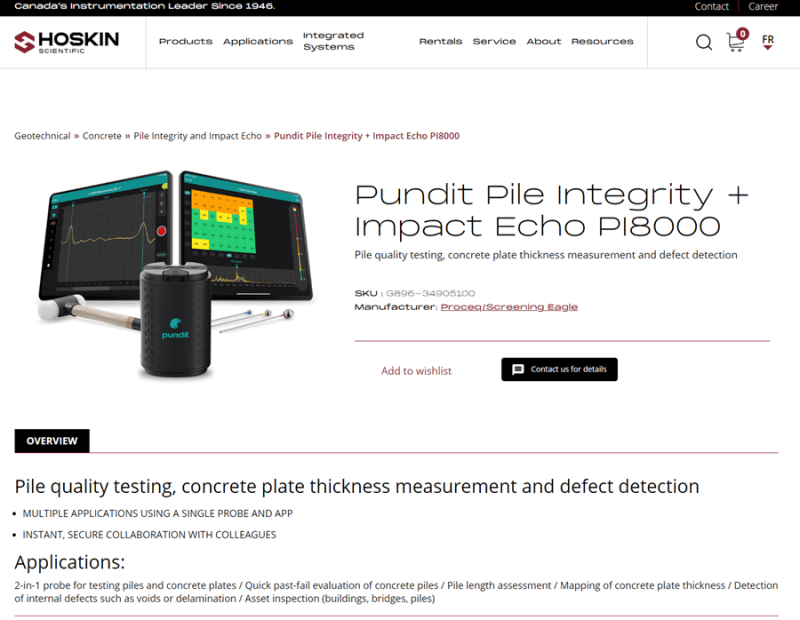

Hello. I'm new to the forum and hoping to gain some insight from the experts! I have been researching trying to find a tool that can be used in the field to test the depth of a foundation. Typical foundation size is 18-24" in diameter and 3-6' deep. We are working on a project that requires us to verify foundation depth before mounting a new sign on it and doing it the old fashioned way(digging a hole next to it) just doesn't make sense and I figured there must be some equipment out there a technician could use to verify depth in lieu of digging a hole. For reference, we've tested the Olson Instruments Concrete Thickness Gauge and that didn't work for our application. I have recently found the Pile Integrity Tester from Pile Dynamics and am looking into that one, just curious if anyone else has done some research and used anything they liked that worked with a high degree of success(90+%). Thanks in advance!

The tool is not difficult to use. We have rented them before to measure the depth of the some piles supporting a silo. In that case it was to prove the foundation was built incorrectly, which it most certainly was based on all the evidence on site. Below is another example from not long ago. In that case they hired someone to do this part. They wanted to re-use a sign foundation for a car dealership. They tested the depth 6 times and reported the average depth of the 40" pile was 11.2'. The depth of all the tests varied from 11ft to 11.4'. I would not get involved as I had no information about the anchors or reinforcing beyond, "it has stood there for X years.."
@Brad805 - Which tool did you use? Do you have name or website you can share? I assume you liked it, thought it worked well and was accurate? I can't tell from your dealership example, did you mean to say the pile was in reality 40" deep(or did you mean 40" diameter?), but the test suggested 11'? That's not good if I got that correctly.
I recall I contacted Hoskin Scientific in Canada and talked with them. The device we rented was like the one pictured below. Google "Geotechnical Equipment Rental" and you should find someone near you. I do not think it was expensive to rent, but that was a number of years ago. For the silo investigation the results were consistent with what we were seeing on site. The owner insisted the piles were much deeper than we believed, and this indicated they were all bearing in shallow fill materials. We did not excavate to confirm the depth, but it was reasonable. In your case it would seem practical to test some with a device, and then dig to confirm. Once you are confident it should save some work and site repair if that is part of the project. I suspect your piles would have been installed with a bobcat. Your depth will not be exact, so it seems you are looking for a minimum depth.
The pile they were testing at the car dealership was 40" diameter. The depth measured by the device varied from 11.0ft to 11.4'. I am not sure if they confirmed that or not. We did not want to get involved. That pile diameter is not uncommon for us, and depths up to 30'-0" are typical. I am in a cold climate. A 3'-6" deep pile would jack out of the ground in our area.
I don't think the PIT testing will be accurate in this instance. When it's been used on projects of mine they need to install a detecting sensor at least 3 feet down the pile so they can get a reference for how fast the waves are travelling over a known distance so they can extrapolate that data for the time it takes the wave to get to the bottom of the pile and back. Since your foundations are at most 6 feet deep, you've already dug most of the way there just to install the sensor. Then I assume when the end of pile is close to the sensor that it will be tough to have any sort of accuracy in the results.
