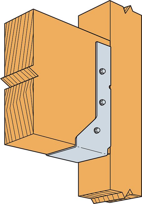

I have a brief question regarding Simpson Joist hangers
Due to some design constraints, I would like to connect a beam to a PT column using a concealed joist hanger. I can't find anywhere where this is prohibited.... or, for that matter, allowed. I have a few different instances on a project where this occurs, but the worst case is where I have 3-1 3/4" LVL's into a 6x6 post with an end reaction of about 1750#. Was thinking about using a Simpson HUCQ610 SDS which has a capacity of over 5,000#.
Any insight would be appreciated.
Can't point to anything saying it is or isn't allowed, but I will say that I've spec'd it before.
I've done that. I don't see why you couldn't. However keep in mind that fasteners into treated lumber need to be hot-dipped galvanized or stainless steel as far as I'm aware. I'm not sure if the standard simpson fasteners are appropriate for use in treated lumber.
Also, why such a heavy hanger. The standard HUC hangers have more than the required capacity you indicate.
Honestly, compared to the column cap we were about to specify this hanger is a far more economical option..... It's the only hanger I have found so far that will fit the 3-LVL's we are specifying.
This is from Simpson's HUCQ product page:
I think it's an acceptable option. I believe the concealed flange joist hangers specify minimum wood dimensions for the "supporting" member so you would just have to check that. I would also consider whether or not you need to apply a reduction for the wet service factor. In my experience PT wood is not dried after treatment to get you out of this reduction.
Check the treatment chemical is OK with the Simpson Zmax (as a default).
