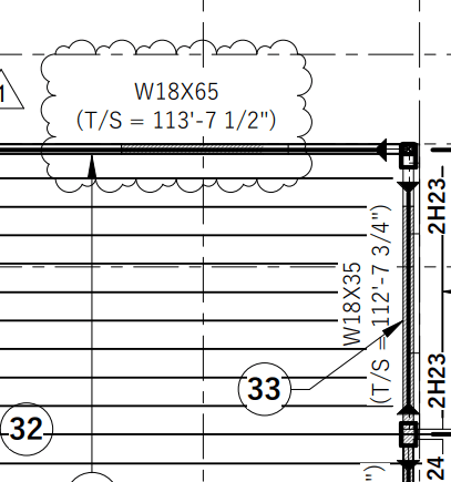

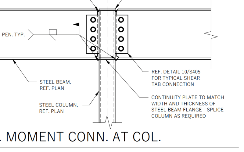

As a fabricator I've been given detail (notes only) for multiple sized WF beams w/moment welds to a HSS column with procedure noted as cut, add continuity plate, splice col. however multiple sized beams seems to make this crazy to me

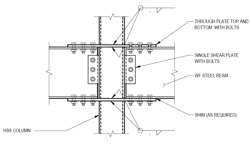

There is no detail but it sounds like this is what your talking about.
Except that there are multiple beams framing at the same elevation and they are of different depths.
Is that what your thinking this is as well??
We have the ability shim between the plates for bolted or welded connections, but there are limitations to that thickness.
It will be an expensive detail, but I think the EOR wants multiple through plates, one at the top flange of all of the beams, and one at the bottom flange of each beam.

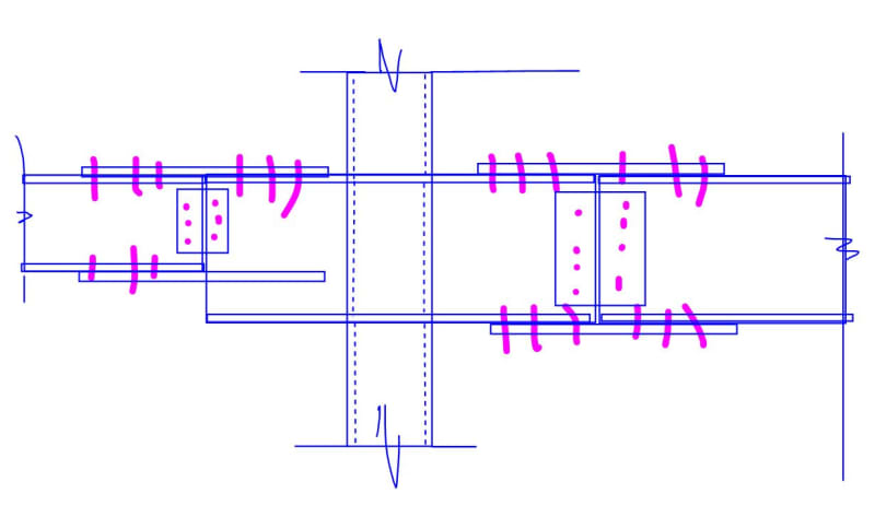

If you have the latitude to do so, it might advantageous to shift the locations of the splicing around to be better suit fabricaton. See one option below. This, admittedly, probably make the column less friendly to ship.
You can weld a WT or filler plate to the bottom of the shallow beam to make it roughly align with the deeper beam.
