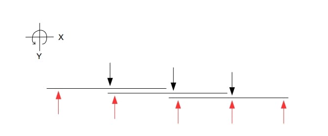

A three-stage telescopic tube is suspended from a total of five mounting points. The tubes are guided by rollers on the inside and outside. The weight of the inner tubes is also transferred to the next outer tube via the rollers.
We need the maximum weight that can be achieved per attachment point. The added total weight will be higher than the complete weight of the entire telescopic tube, as the weights shift depending on the position.

In telescoping systems, the retracted state is usually the least problematic. So, you should do all your load calculations in the fully extended state. You will have to look at each individual segment to analyze the forces, moments, centers of mass of each body, and reactions at each individual support point. And of course, those factors add up as you proceed from the smallest tube to the largest.

If you only want to consider where and how the weight is distributed then, in physics or engineering, this is considered a static analysis. The first concept you will need to learn, is how to draw a free body diagram. Please look up all of these terms because other will likely communicate these concepts better than me.
So, terms to look up:
Statics, free body diagram, normal force, reaction force, distributed load, shear, moment.
And two statements which you will need to understand:
The sum of all forces
The sum of all moments
Your free body diagram should look something like below:
to give you an idea ... say the extended tube above has a load on the LH end of P and is attached to "the rest of the world" at the two RH arrows (call them RH_left and RH_right). Take the view at face value, so that there are four (equal) spans between loads. The RH_left will be 4P and RH_right 3P (or more correctly -3P) ... these two forces balance the applied load "P" at the far LH end.
