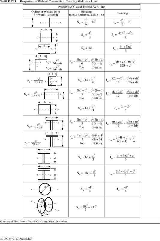

Dear Sir,
Please share calculation procedure to determine section modulus of weld all around I beam (e.g. W10x49).
Regards,
Ijaz
section modulus depends in I, the second moment of area. A weld is a "line" with some width. Does that help ?
Please share formula for weld all around I beam.
Here is copy of weld section modulus from the Design of Welded Structures book I indicated in previous post. You can do a search for "weld section modulus tables"
