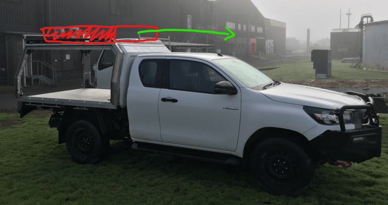

I am currently designing an aluminum frame for the rear of a truck bed.
The frame will be load bearing and have a dynamic rating of 150kg. I have been asked to perform some 'crash testing' on the frame prototype. This requires a certain amount of force to be exerted on the assembly in a horizontal direction. See example here of a roof rack test performed on a track (
I do not have access to a track or testing facility so was wondering if there is a good way to perform a bench test via pulling on the assembly using a winch or similar device.
What sort of calculations would you recommend to determine the correct load or force? The testing standard ISO11154 states that the load has a force of 8g applied to it and is tested to 1.5 times the stated capacity.
Sorry if this is a tad vague, as you can probably tell I am not a structural engineer, merely a lowly CAD monkey! :)
Any help would be appreciated.

1) Are you sure this is the same crash test? Your device looks like it forms part of the structure of the vehicle?
Where are the fixing points?
what loads are going to be imposed on it in a crash?
Is it just a frame?
but a crash test is a crash test, not a static load test.
You could mount it on a vehicle and have it reverse at 16km/h with some strong ropes / chains attached to the front and then see what happens?

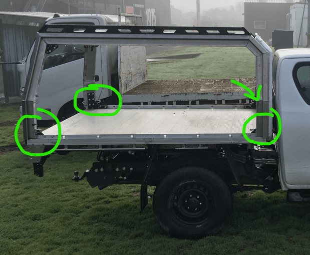

I am curious as to whether I can estimate the loads generated in the dynamic test and then simply apply a load similar to that (in a much slower fashion). I have a physical prototype which I can use for destructive testing.
The frame is bolted down through the aluminum flat deck using two 5mm thick steel brackets on each foot. The aluminum flat deck is sandwiched between the steel brackets. The frame and flat deck will be removed from the vehicle and bolted to the ground for testing.
...essentially I am trying to figure out if I can create a test that would mimic the results of the dynamic test using basic workshop equipment.
Where are the fixing points?- the device is the upper frame assembly. Fixed in each corner using a series of 5mm thick steel brackets.
what loads are going to be imposed on it in a crash?- 225kg at 8g
Is it just a frame?- the frame is the structural component. It does have thermofomed ABS doors but these wont be included in the test.
but a crash test is a crash test, not a static load test.- I am aware of this, but I am trying to figure out if its possible to create a new test that would provide a similar result. Limited resources are the issue here.
You could mount it on a vehicle and have it reverse at 16km/h with some strong ropes / chains attached to the front and then see what happens? I like your thinking! Not sure the owners of the vehicle would approve :s

Sriddle,
I think that you are in fact in quite a dangerous place with this device.
From what I can see this is basically a framework designed to fit on a flat deck or perhaps include the flat deck - I don't really know what's "original" and what is your contraption. It also appears to have roof rails on ot so that, as you show on your pcture, you can stick on roof bars or roof boxes or whatever like a normal car.
The potential for serious injury is twofold.
One - in a collision this framework and what ever is inside it or on top of it rips itself out of it mounting and comes off and hits someone
Two - It does the same thing but crushes the cab from behind or allows the roof bars to come off and do the same thing.
doing something for yourself where you take the risk is one thing and doesn't negate item one, but if you're trying to sell this to the general public, then trying to cheapskate around the testing requirements is simply going to put you in deep trouble in the inevitable event of a collision. So I think you might need to do a bit more serious consideration here about what it is you're trying to do. IMHO.
Probably the 10 stacked ladders the painters transport with a few bungie cords will become the projectile long before this will.
Assuming that this is just a cargo rack:
I see where LitteInch is coming from but I would tend to agree more with XR250 in this case. The random parts you have half heartedly attached will cause more concern in a wreck than the rack itself. You would have to make some assumptions about your G's but some pretty basic shear/moment calculations with a generous safely factor should be enough to make sure it will stay attached in the event of a collision. It looks to me like it may be aluminum, but even in the case of it being steel it is still a relatively minor structure, I wouldn't get too concerned about it causing a major cabin failure in an accident.
Let's say you rate this to carry 200KG. I would design and physically test it with 600-800kg in a vertical compression test, as well as being loaded in all of the directions that it could see that force while the vehicle is off camber, like while climbing a slope on a trail. If your vehicle will tip anyway at 40 degrees, I would test your 800KG load being applied at a 40 degree angle. Should the vehicle be involved in a major accident, it's just a roof rack, write it off and call it a day.
