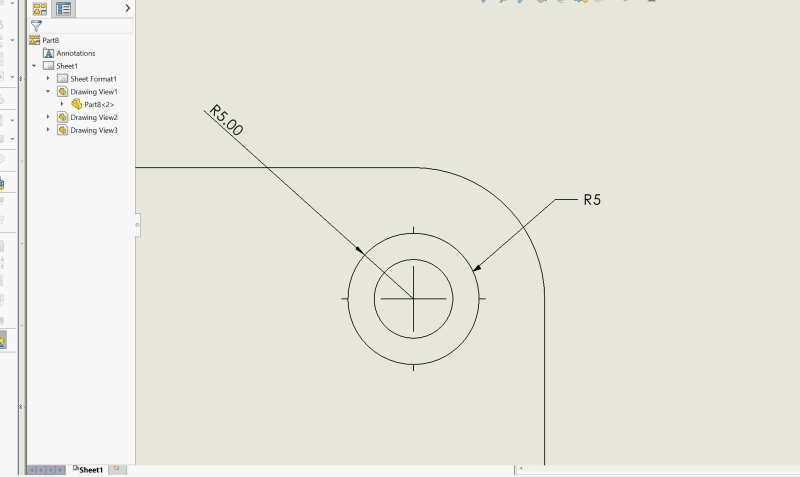

How could I set my 2D dimensions (from the right end style to the first/second one?

Is there any way to create the radius or diameter dimension as they are in the first two samples in the picture?....
CAD 2015
Yes. Of course. You will need to have appropriate drawing views first. Click "smart dimension" icon and then click the edges. You can change radius to diameter or diameter to radius by right-clicking them.

Alex,
The shape of the two dimension on left are different than the last one on the right.
They have 1 arrow only and their position is horizontal.
That's what I want to get...............

Alex,
I want to make the left R5.00 dimension identical with the one on the right R5( The one on the right is faked, created for comparation, using line+text)

Your dim. R5.00 is created with ISO drafting standard. If you switch it to ANSI (or ASME) standard, this dimension will become R5.
To change drafting standard, you use these menus below:
1. Click System Option;
2. Click Document Properties;
3. Change Drafting standard to ANSI;
I'll let you know if I can find exact attribute that control this behavior. Meanwhile, you can play with dimension styles.

There is a "Custom Text Position" option under /Dimension/Leaders. It controls orientation of texts in dimensions.

I got it.
