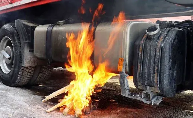

Just avoid the direct fire method.....
[URL unfurl="true"]https://res.cloudinary.com/engineering-com/image/upload/v1718730390/tips/ANVe3kLGG72OHQPFt9fyZLi45dpico5GciGZGqSQ-7A_r1avbt.webp[/url]
