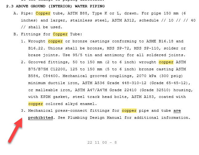

Our firm used to do multi-disciplinary work for the VA at several sites, as well as wrote the first couple versions of the HVAC, Plumbing, and Electrical Design Manuals. The VA has 165-ish major hospitals, and almost 3x the number of Clinics and smaller facilities. So when they have a problem with a new product, it has the very real potential to be HUNDREDS of problems... So they are usually rather conservative in their adoption of new products.
When this type of product came out, they held back a couple years in being approved. Then they allowed it for a couple years. Then they started having problems with failures and leaks on hot water distribution systems, primarily (I think) due to the repeated longer-term thermal cycling. After a few more years, vendors apparently solved that problem, and eventually (several years ago now) the system was approved for both cold and hot water systems.
We have not done VA Projects now for several years. Looking (today) at the current VA Spec 22 11 00 for Facility Water Distribution (available on the VA TIL (Technical Information Library) - which is freely available national treasure of design info, paid for by your tax dollars - highly recommended as an authoritive source for many disciplines), it appears they are now NOT allowed:
Say what you will about government organizations, but the VA usually have valid and proven reasons for every decision they make. IMHO, ignore their recommendations (if you were working for the VA, this would be a requirement) at your peril.
That said, I believe both UPC and IPC both approve these fittings (I would suggest you confirm) - but those organizations are not responsible for what happens when these do fail, and jeopardize the infrastructure and patient care at hundreds of Health Care Facilities around the country.
And THAT said... there is no doubt they are first-cost cheaper. [ponder]
