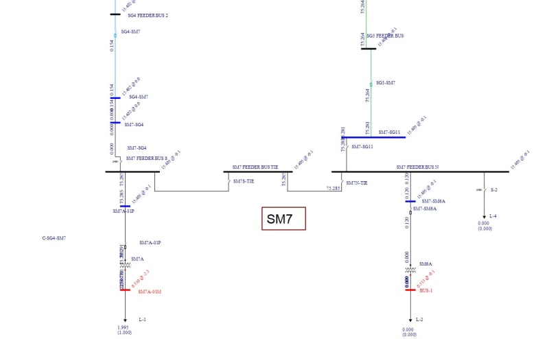

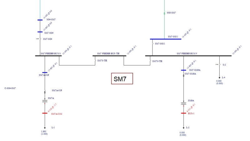

Oops.... The Client had guestimated 200V of voltage drop to where this hot switchover is located in the Plant. There is no metering at that point to confirm it.
Thus why we are trying to model it. But I input the data wrong on the original above. He told me the transformer tap is set to 4R which equated to 141.54 kV and the secondary voltage is measured at 15.40 for Utility 1. Utility 2 is metered at 15.40 kV. So it's more like 3 Volts per the software. Another issue of concern is the Capacitor Banks at Utility 1 being connected which adds to the voltage, so we still have the same question.

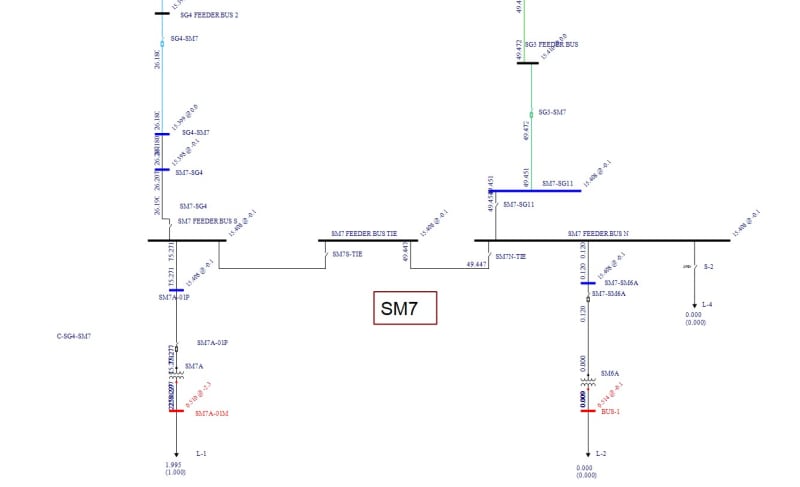

This the currents with only the Utility on the right feeding it. Below that is with the switch closed.
