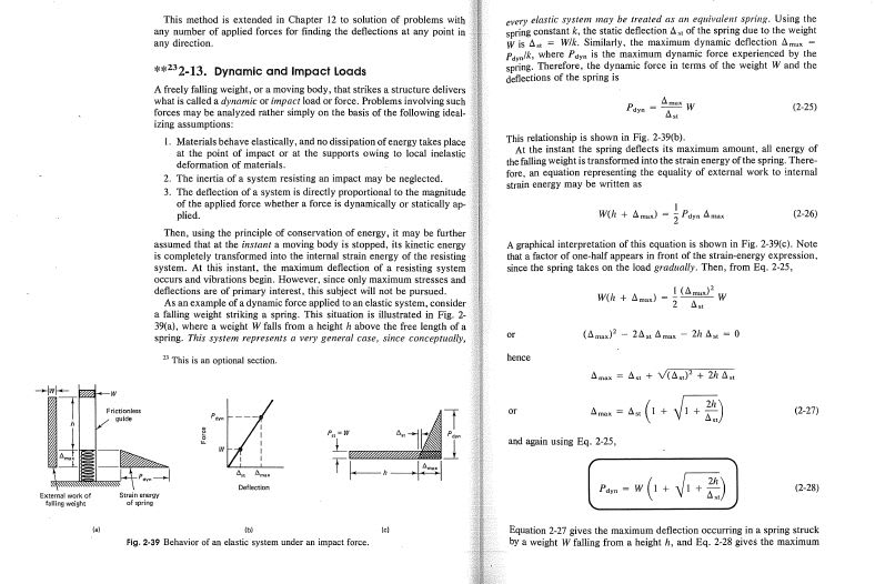

Hi everyone,
I am looking at a preliminary impact load calculation of a freely falling mass on a composite floor. I am attaching a table that has the impact factors for different impact cases but I am not where this table is taken from (I took a snip from a YouTube video), I searched in the AASHTO and the ASCE 7 but could not find it, could anyone please advise on that, if there is such table in one of these codes or any code?
Regards
 https://files.engineering.com/getfile.aspx?folder=a129b714-980d-432c-9a4c-30365eb024e3&file=Screenshot_2024-06-05_220827.png
I've never seen it in code....but I've see similar formulas in Blodgett's 'Design of Welded Structures'.
The formulas in that table could be found at strength of materials books . All of the formulas assume elastic impact , that is , no energy dissipation . The following snip shows the derivation of first formula using energy equations .( From E.POPOV )
The second formula can be derived using h=0 at first expression
The third one can be derived using h=( V**2)/(2g) at first expression
I will suggest you to look EN 1991-1-7 (Part 1-7: General actions — Accidental actions) to see how the impact forces incorporated to structural design .
