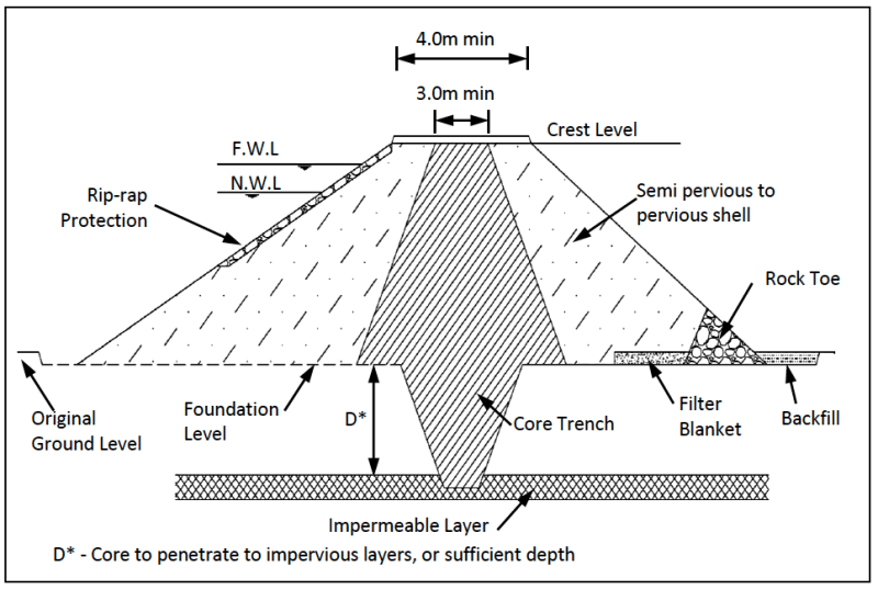

Normally you do GI to tell you things you don't know or need to know in order to undertake design work.
You know the dam wall is falling and needs to be replaced in entirety at a lower slope angle.
Retaining walls are not simple and then you do need to know what's in the ground underneath and get a proper design.

You could do worse than Google " dam design manual
Your GI work could identify the layers underneath. Soft toe either means there is no key into the existing soil, or is getting underneath that or your drainage system is poor or non existent. Slope angles typical 2:1 or better
l "
A couple from USACE, and international organisations might be good bedtime reading...
