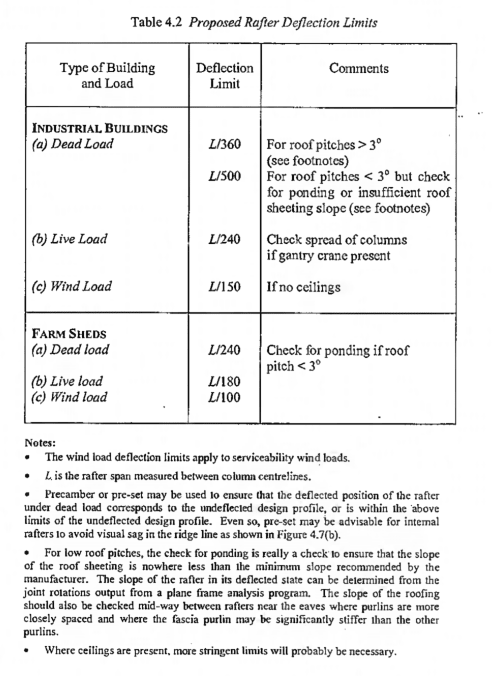

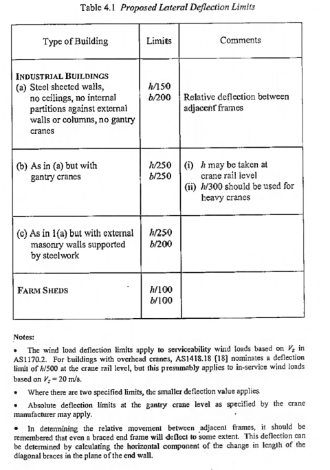

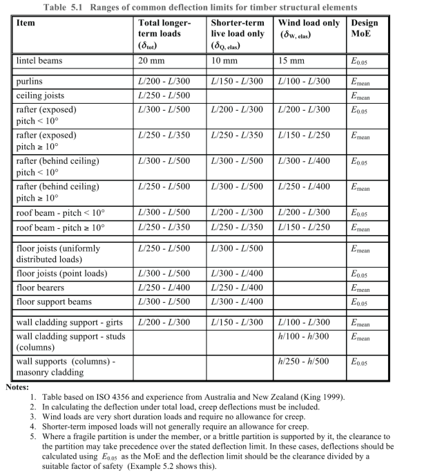

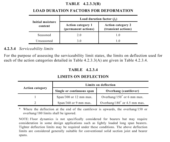

See attached a paper from the ASI for steel deflections, extracts from a portal frame design textbook, recommendations from Timber design handbook HB108-2013 and AS 1720.3:2016. I find the criteria from AS 1720.3 confusing as most other references allow L/360 for dead load and a less strict deflection for live load. This appears to be the other way around.

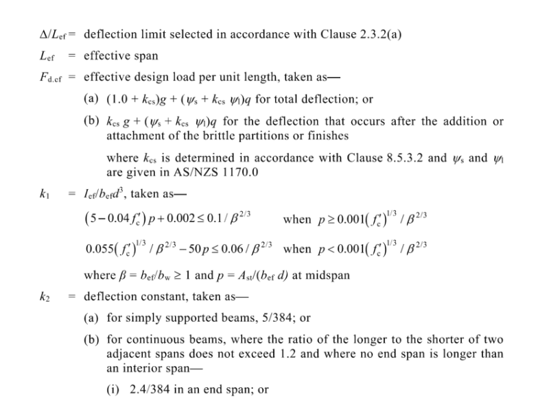

What is wrong with AS3600 table 2.3.2 for this?
I did not think to refer to AS3600 but yes table 2.3.3 is a great table for this so thank you very much I appreciate it. Just to make sure I am not making any mistakes. Would the incremental deflection load combination generally just be creep + long term live load?

Have a look at As 3600 Clause 8.5.4.
Clause a) is your long term total deflections
Clause b) is your incremental deflections. The only difference between these 2 equations is the 1.0g factor is removed as your initial deflections are subtracted from your total deflections.
