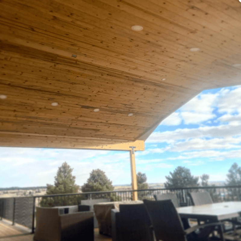

Do the dropped beams in the photos below follow the intent of the code? This seems to be industry standard deck construction, and there is pressure from contractors to go along, but I'm not a fan for 2 reasons:
1. The bottom of the beam is in compression where continuous over posts and wants to kick out to the side. 2024 NDS 3.3.3.4 says "lateral support shall be provided at points of bearing to prevent rotation." I guess a hefty post cap could prevent "rotation", but not "lateral" translation. I read thru the NDS commentary and AWC NF&PA TR14 Lateral Torsional Stability but did not find any additional guidance. I don't feel great about it, but owners are not okay with stabilizing kickers or blocking on most jobs.

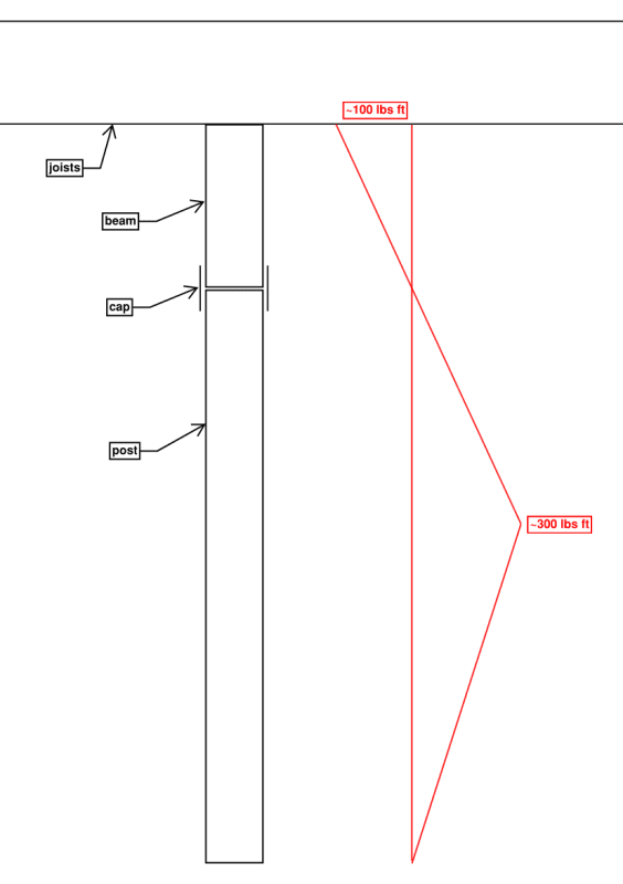

2. Anyone who happens to push on the post puts the beam in perpendicular to grain bending, and counts on moment transferring thru a post cap couple, which will rotate significantly before the cap engages. A typical moment diagram is sketched in red below. The moment is small, but I don't feel great about it.
Section R507.5.2 of the 2018 IRC states that the post to beam connection must resist horizontal displacement. In at least one photo the horizontal displacement does not appear to be resisted. Not very stable looking to me.

You are correct - not stable and not code compliant...though most inspectors will see some sort of Simpson connection and say okay. I'm pretty sure the prescriptive (here we go again...) section of the floor chapter for decks just says you need a post cap and it's okay. Unfortunately, the post caps have in their literature that they aren't suitable for the purpose of restraining rotation. I'd be willing to call it good with some heavier steel plates and a bit of analysis...but the thin stuff from Simpson is no good there.
The worst part about the top picture, though, is probably the 6x6 that's a good 20' long. Probably just squeezes in under slenderness rules, but yikes. The other worst part about it - it looks like a free standing deck. The house floor framing is cantilevered over the back door and there looks to be an offset between the ledger and the wall, so it's a single ply beam. The post arrangement seems to suggest the same. So it has minimal positive connection back to the house, no lateral restraint on the outer edge...this whole deck looks really sketchy to me.
Your post is treated as a pinned/pinned connection, and it's up to you to determine the methods to achieve this connection type. As shown in the photos, not a good way to transfer lateral shear as you've described, a column cap would probably help with that, however. With wood design, I would assume the moment is only in the column, and there is no moment transfer at the beam (pinned/pinned), and thus, would not be concerned with a rotational moment at the beam base for this design scenario.
I 100% agree with Pham, first thing I saw that concerned me on this was the slenderness of that rightmost column, maybe it works out, but it does give some concern.

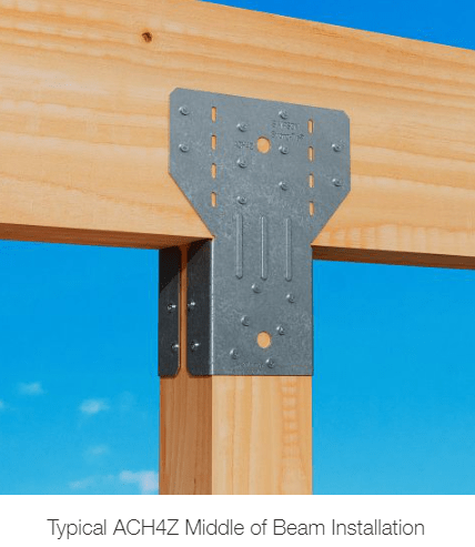

Eric, I am fine with calculating Simpson hardware capacities for cases where Simpson has not gotten around to testing it yet. I know they say "no equal" but what they don't tell you is it's just a hunk of steel with some holes drilled in it.
I think the standard we might settle on is the cap below. It's just sheet steel, but it's bigger than the LPC caps. I would love to use the CCQ caps but CCQ has serious aesthetic implications.

2. are you suggesting the moment diagram is below? how are you transferring moment between top of beam and bottom of joists? are you comfortable with flexure perpendicular to grain and across multiple plies? seems dicey to me, but I guess it's probably fine for such small moments.

Mike Mike, I share your apprehension about the type of beam on column bearing connections in your OP photos. In my opinion, lateral stability of the beams at the column bearing locations is greatly increased by notching the columns and bolting the beams to the columns as shown in 2018 IRC Figure R507.5.1(2) instead of using flimsy post caps.
gte and lex, I agree and have typically been requiring simpson ACH caps at a minimum. I just talked to a deck inspector with the county with decades of experience and he said he does require contractors to add bracing for these situations. he said he tells contractors that cap manufacturer instructions require beam to be stabilized. but I spent an hour hunting thru simpson website, esr, catalog, general notes, and product installer's guide and failed to find any mention of anything like this.
Mike Mike - in the 24-25 catalog, check Bases and Caps General Notes, note k, on page 67, and all of the lateral direction arrows. It's not as bullet proof as you probably want, but it infers that it can only do that.

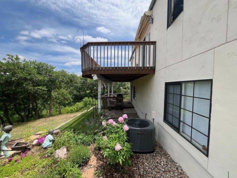

phameng, I still didn't have time to dig into your links yet (doing real work over here), but came across another dropped beam. this one is probably fine right?
Yeah, I think that big crack through the rotten wood really adds to the stiffness. [banghead]
There is definitely a hinge where the beam bears on the column. However, if a deck was built with a real diaphragm (not trex) and has the tension tie backs to the house, then the top of the beam should not rotate. The bottom of the beam can still rotate from wind load on the post, but, the non-decorative Simpson post caps should be able to resist the load. Even if their literature does not have a value you can check the light gage steel for weak axis bending. Loads will be small.
