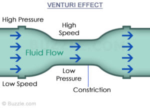

What principle causes the pressure to drop? Bernoulli's equation can describe why the pressure is lower INSIDE the valve (the fluid is forced through a narrower passage which accelerates it and thus the pressure drops) but when it exits the valve, the size of the tube is the same as the inlet of the valve.
In the above image (venturi effect), the pressure drops in the narrow passage, HOWEVER, it is recovered when it enters the larger section again.

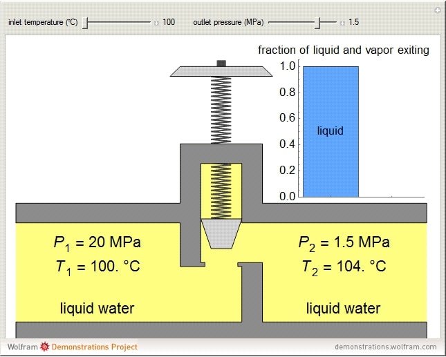

This is NOT the case for expansion valves. Below is an image of a throttling valve which has a similar geometry to a TXV:
Something about the sharp edges of this geometry prevents us from recovering the pressure even after the narrow passage. What physical process can explain this? What exactly are the molecules of the fluid doing differently between a venturi and a valve that allows it to recover pressure in one but not the other?

The recoverable part is hydrodynamic, ie the Bernoulli part. The nonrecoverable part is essentially friction, no different from any other head loss.
Edit to add: In real life venturis, not all of the pressure is recovered.
In a venturi pressure head/energy is converted to velocity head/KE with no enegy loss and then converted back to pressure head without loss, assuming perfect venturi with no friction loss. For a throttling valve pressure drop is cased by friction loss which is a force times distance type work the fluid need to expend to get through the valve. This is a permanent energy loss and that goes back into the fluid as heat (which is true for both liquid and gas flow) so that the enthalpy of the fluid remains constant although pressure permanently drops.
The bernoulli equation / theorem is based on frictionless fluids. As noted above in reality venturis, even small smooth ones have some level of friction losses and hence pressure on the d/s side is always lower than the upstream side.
In a control valve scenario the friction losses are much much bigger. As noted above by others, if you maintain the fluid as say a liquid at all times ( i.e. at no point does the liquid go below bubble point) then the liquid will increase slightly in temperature due to the frictional losses as it reduces in pressure.
In a refrigerant liquid, this heat gain is much smaller than the heat loss due to the change of state from liquid to gas and hence the gas cools down. Maintenance of the pressure difference and low pressure in the evaporator is undertaken by the compressor.
