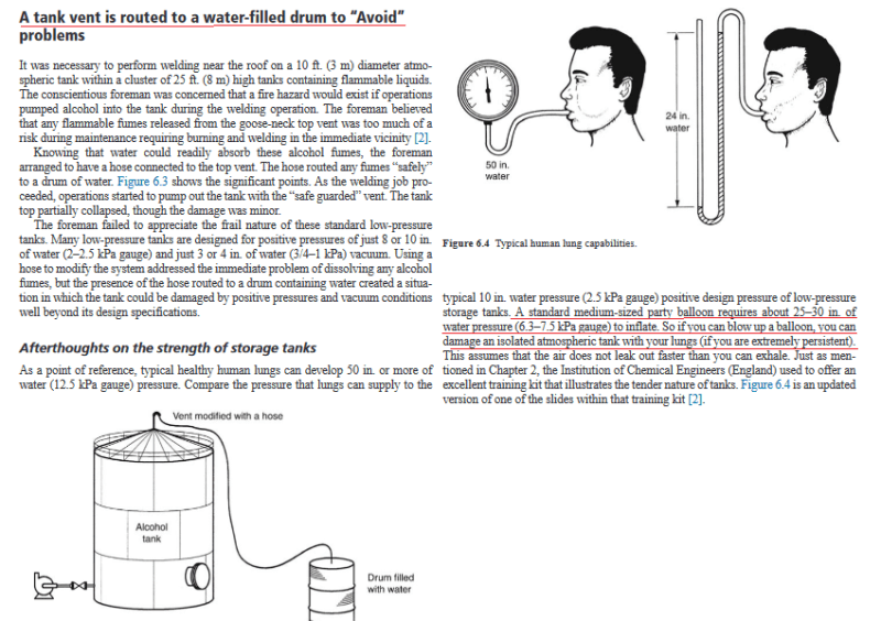

I am checking the requirement if there is a need for Pressure/vacuum relief valve on a slurry tank.
API650 design check, internal pressure was calculated at 8.1kPa. I believe API650 allow for up to 6.9kPa.
However, there is tank overflow to a seal pot downstream (built to AS1210),
which probably mitigate the overpressure and vacuum effect in the tank.
I wonder if a pressure/vacuum relief valve is still required?
Previous experience with tanks - they have their own relief valve. But not this one.
Tank has a frangible roof to shell connection. Would it make a difference if it is not, in this case?

designed or listed as "atmospheric" pressure is limited to 1kpA (4in wc) Really.
API 650 tanks CAN be designed up to 2.5psi / 18kPa, but need to be specially designed for this to Appendix F
Vacuum is 0.25kPa (1in wc) unless otherwise designed.
API 650 tanks ( how big is this??) really really don't like negative pressure and will and do collapse with very small vacuum pressures.

Well 8 in wc is 2 kPa...
Maybe the roof has already detached from the shell and all the air inflow and outflow is happening though a gap between the roof and the shell?
As you've drawn it it is very odd, but much depends on what this seal pot actually looks like / size, flowrate, pressure etc and if it has any liquid in it on how it "seals"....
The tank needs to be vented, but that can be accomplished in different ways.
For example, it can have an open vent and no pressure/vacuum valve at all.
It can be vented via piping away from the tank, but whether that works all depends on the details of what is out there.
If I remember correctly, the way API 650 is worded, the pressure should not exceed the design pressure when venting, which require a set point at some lower pressure. IE, don't confuse the design pressure and the set point pressure(s).
To complicate things, there have been quite a few revisions through the years to the pressure/wind overturn criteria, so what the maximum pressure can be may depend on which version of API-650 you use (generally, lower allowed pressure with newer versions).
The tank needs to be vented to handle vapor displcement rates based pumping of liquid in and out. For a slurry tank I would just use a goose neck open pipe vent. Refer to API 2000 for sizing and other requirements.

Seal pots can in theory be used as pressure relief but are not used much these days due to reliability concerns - seal pot has to be kept filled at all times, risk of blockage from internal corrosion, biological growth. Low vacuum relief protection is almost impossible due to slug flow up the long ascent when liquid seal is overcome by vacuum conditions in the tank.
