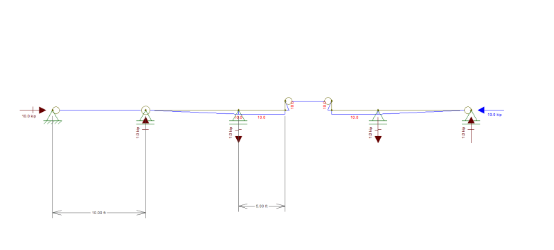

I've come across a simple (almost shameful) question that has me stumped. The initial question is whether we should "offset" all of the beams in our FEA models of steel structures so that the top of the beams all is level, which is how it's going to be in practice. I've never done this, but thinking about axial loads in collector beams, I'm now wondering if there's a hidden moment I should be considering (and if there is, where should it be considered?) The two practical cases I can think of are:

B - different height of beams in a gerber system

For B, this one has me stumped. I don't think it's a good idea to use a full moment connection, that would remove any efficiency gained using the Gerber system. Maybe the connection needs to be full moment on one side only? I can't visualize what would happen if I kept regular pin connections there and was a huge axial load. Would the ends of the large beams "curve down" to better align with the applied load?

For case B, you do not need moment connections for the drop in.
The eccentric axial load will cause an end moment at the Gerber cantilevers, which is resolved by the supporting columns the same way as vertical loads.
Case B:
Edit: The blue line is the moment diagram.
For Case A, I wouldn't be too worried as the effects will be localized. You need to account for that moment in connection design and considering local effects on the column, but it's not going to impact the global model appreciably. (A small amount of shear at the base of the column, but unless it's a moment or braced frame column designed to a 0.99999999999999999999994 utilization, it's probably not going to change the design.)
For Case B, yes. That eccentricity will result in variations throughout the model and it may be wise to consider it.
Be careful, though. Those offsets are usually done by using rigid links (sometimes behind the scenes), and those can screw up results. So be mindful of that and monitor the results closely. Might be best to run it without it first and then change the offsets and see how the results differ and whether or not they make sense.
