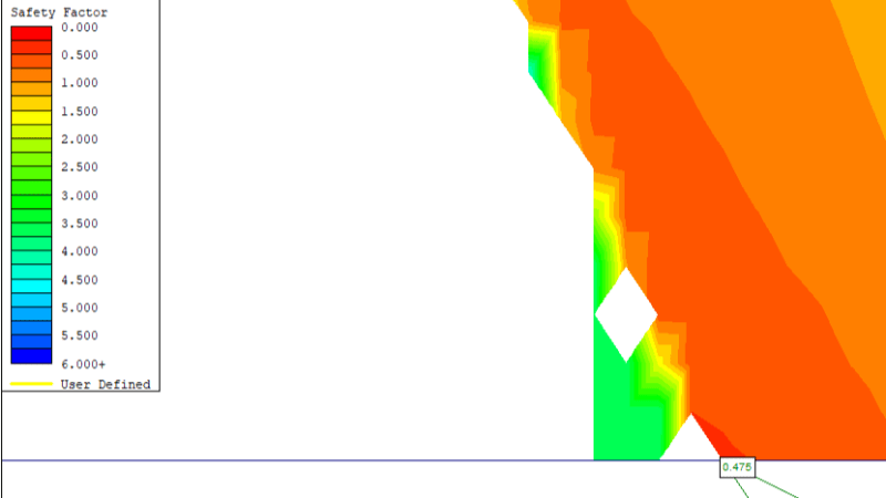

Anyone familiar with slide 2 can explain to me why this is failing?
Because the driving force is greater than the resisting force? Sorry, cheek answer.

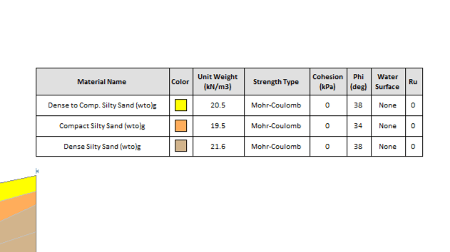

What are the rest of the properties of the different soil layers? How are those walls modelled - as impenetrable / infinite strength? Can you post a sharper image - scale is hard to read. It looks like you have a pseudo-static earthquake load applied - what does your static case look like?
To me it looks like you have a 1H:1V overall slope and the only soil parameters are phi=34 with 0 cohesion. So yeah that will have an FOS < 1 with an earthquake. It will probably be less than 1 in static as well or close. You should end up with lowest FOS for the shallowest possible failure surface using your search technique using c' = 0, which although I can't tell for sure since I don't have all the details is probably passing right under the toe of your walls in this case.

The static conditions without the earthquake load is still failing at a FOS of 0.7.
The soil has little to no cohesion, it is unfortunately unfavorable building conditions, and the area is located in a fault zone, hence the earthquake load applied. I am a final year student, to provide some context. Even though we were taught in class, I am humbly reaching out to expert minds to find a way to stabilize this particular slope scenario.
To your other questions asked,
The wall is not impenetrable or has infinite strength. They have an active force application of 100kN
Yes, the failure surface passes under the toe of the wall and does so each time I increase the depth of the wall to pass the failure slope.
I am considering reducing the overall slope and see if that makes a difference.
What I would like to know is recommendations to achieve an acceptable FOS.
Extending the piles / wall deeper in the model will drive the failure surface deeper which will increase the FoS, yes.
What is the 100 kN active force application coming from? An anchor? Or shear resistance of the pile on it's own?
Your wall is failing because you essentially have a 1H:1V (45 degree), or steeper, slope with predominately 34 degree soil and no cohesion. I think you need more horizontal setback between the terraced walls in order to flatten the slope to probably 2H:1V or you need ground anchors or geogrids for each wall section. Also, have you considered live load surcharge(s) behind the wall(s)?
