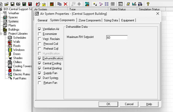

I am designing a clean room with 40% RH by using a Split AHU with HAP4.9 Software. How to set Desired RH value.
in the system, you can select the desired RH but even after setting the RH the HAP will specify the RH based on the set selection criteria.
Thank you Taha,
Kindly explain what do you mean by Set Selection Criteria.
